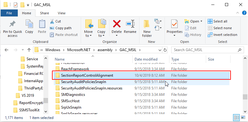

    I’ve created a custom assembly that has been signed and even added to the GAC. Yet when I try and use it in a Section report I get the error that the assembly cannot be found.
    GrapeCity.ActiveReports.ReportScriptException: Report Script Compile Error on line 2:
    The type or namespace name ‘SectionReportControlAlignment’ could not be found (are you missing a using directive or an assembly reference?)

    The report will end up on AR server in the end, but right now I’m trying to run in locally with the end designer. Currently, it’s a code based report that’s being converted over to an XML based report, since other developers may need to work on the report in the future and we only have 3 pro licenses.
    In any case I have the following in the script just to start with in order to figure out how to get the assembly referenced. Again keep in mind it’s a code base report that’s being moved over to XML based, and the code based works fine.
    const string SPROC = "rpt_usp_109X_TaxForm";
    DataTable TaxData;
    int RowCounter;
    System.Data.SqlClient.SqlConnectionStringBuilder ConnStr;
    public void ActiveReport_ReportStart()
    	rpt.AddScriptReference("SectionReportControlAlignment.dll");
    	SectionReportControlAlignment.MicroAlignment AligmentSettings;
