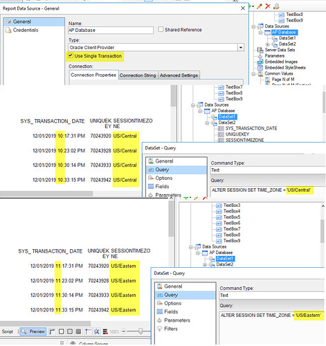

    This is close, if I set the data source to be a single transaction then put the ALTER SESSION SET TIME_ZONE into the first data set. The second data then shows data in whatever time zone I set the session too. Ideally I’d need it to be a process less visible to the user though
