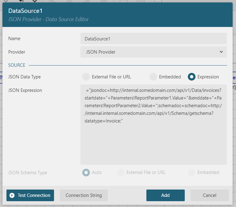

  • Posted 26 May 2022, 9:45 am EST - Updated 30 September 2022, 4:25 pm EST
    I think I’m still confused. What we are currently having to do is on every report that uses, lets say the invoice api, which takes in parameters for a date range, we have to add it to the report like below:
    What we want is for that datasource (and others) to be prepopulated in the Datasource list when ever we open the designer to create a report.
