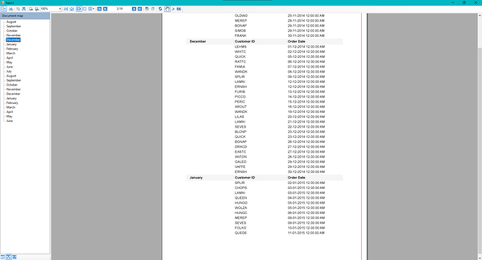

    Hi! Is it possible to configure to use the sidebar to navigate a report by a group value. e.g. I have a report grouped by date, say 4/1/2023 and 5/1/2023. Is it possible to have the sidebar list these dates, and jump to the group in the report where this date starts? (There’s a group in the report layout based on this date). Thanks!
  • Posted 21 April 2023, 1:36 am EST - Updated 21 April 2023, 1:42 am EST
    Hi Robert,
    Yes, you can add bookmarks to your report sections which you can navigate using the ‘Document Map’ tab in the Sidebar.
    To learn more about Bookmarks please refer to: https://www.grapecity.com/activereportsnet/docs/latest/online/bookmarks-section.html
    We have also attached a sample application implementing your use case, you may refer/modify the same as per your requirements.
