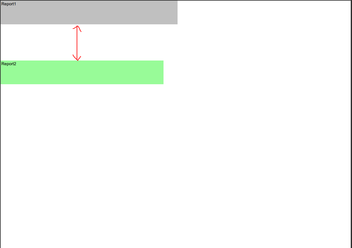

    I has two report and when i merge multiple so i can’t set space between previous and added report is nothing.
    combiner.AddReport(report1);
    combiner.AddReport(report2, new LocationOptions() { PageBreakBefore = false, Gap = "0cm"});
    i try set for example but can’t fix problem!
    Thank you watching!

    Hi Nguyen,
    The space you are getting between two combined reports is due to ReportCombiner’s DefaultStep property. DefaultStep defines the default gap between two adjacent combined reports. It is set to 1 inch by default.
    Refer to the code snippet below in order to remove any gap between the two combined reports:
    combiner.DefaultStep = "0cm";
    combiner.AddReport(report2, new LocationOptions() { PageBreakBefore = false, Gap = "0cm" });
    Please find attached a sample implementing the same.

  • Posted 15 November 2022, 11:50 pm EST
    i did it, thank’s for support
