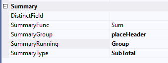

    We are using ActiveReports 15.2.0 with a SectionReport to generate a PDF.

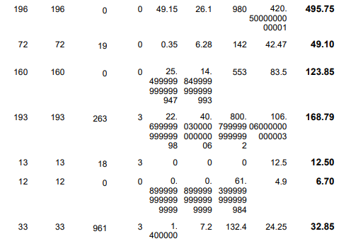

    We have some cases where a Sum SubTotal on a Group is returning numbers with erroneous decimals. The DataFields being summed are of type System.Decimal and represent numbers that have a maximum precision of 2 decimal places.

    Can you try to change the “Output Format” property of the Textbox to “#,##0.00”
