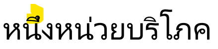

    I made a very simple console app to generate the pdf, to remove any chance it was our code causing this issue, the pdf exporter looks like this:
    var pdfExport = new GrapeCity.ActiveReports.Export.Pdf.Section.PdfExport();
    pdfExport.ConvertMetaToPng = true;
    pdfExport.ImageQuality = ImageQuality.Highest;
    Here is the text correctly renedered in html
    Here is the text redered by pdf
    And here is the rpx which generated the documents

    Can you check with the latest build i.e AR15.2? I have checked the same at my end and thai characters were rendered successfully.
