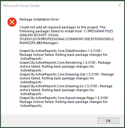

    I created a .Net Standard 2.0 class library and attempted to add an Active Reports 14 Section Report (code-based) item. It starts installing the NuGet dependencies, but quickly fails and rolls back with the following message:
    As a result, I’m unable to view the designer or work at all with the report. Any help would be appreciated. I’m currently using VS2019 version 16.4.3 and AR 14.0.19026.0.

    Hello Jason,
    There is some problem with the Codebase report with the release build. We are working on this and will provide you the hotfix in end of this week or the start of next week.

    No luck. I get this error before and after using /ResetSettings
    If I try to install that package manually, I get the following errors:

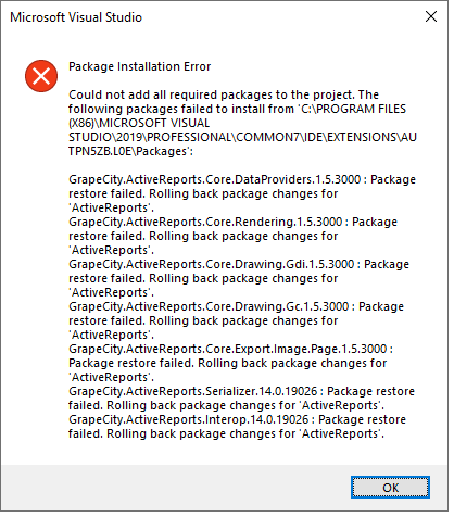

    I’m experiencing similar issues trying to add a Section Report (code-based) to a C# class library (.net standard 2.1). ActiveReports v14.0.19213.0, Visual Studio 2019 16.4.5. Package installation fails
    I tried restoring one of the packages (GrapeCity.ActiveReports.Core.Rendering) manually and observed the following output and errors:

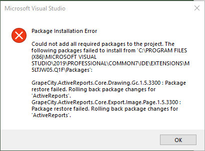

    After manually updating the System.* nuget packages (that AR had installed as dependencies) to latest stable versions, I was able to restore the missing GrapeCity.ActiveReports.Core.* nuget packages except:
    • GrapeCity.ActiveReports.Core.Drawing.Gc
    • GrapeCity.ActiveReports.Core.Export.Image.Page
    Here’s the info from those package restore attempts:

  • Posted 2 March 2020, 11:54 am EST
    Could please try with the latest hotfix. You can download the same from the following link:
    http://cdn.grapecity.com/ActiveReports/AR14/Hotfixes/ActiveReports-v14.0.19484.msi
    Also, please uninstall the previous and then install the above one.

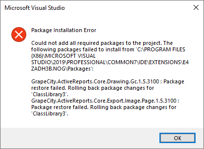

    No luck. Adding a new Section Report (code-based) to a C# class library (.net standard 2.1) still fails. Using ActiveReports v14.0.19484, Visual Studio 2019 16.4.5. Error details:
    Here’s how the dependencies look after attempting this:

    I have escalated the issue to our development team(278633) and will inform you once I got any information from them.

    Sorry for the delay!
    I have discussed with the development and found that currently, it is a limitation of AR. SectionReports is not supported in .Net Standard environment.
