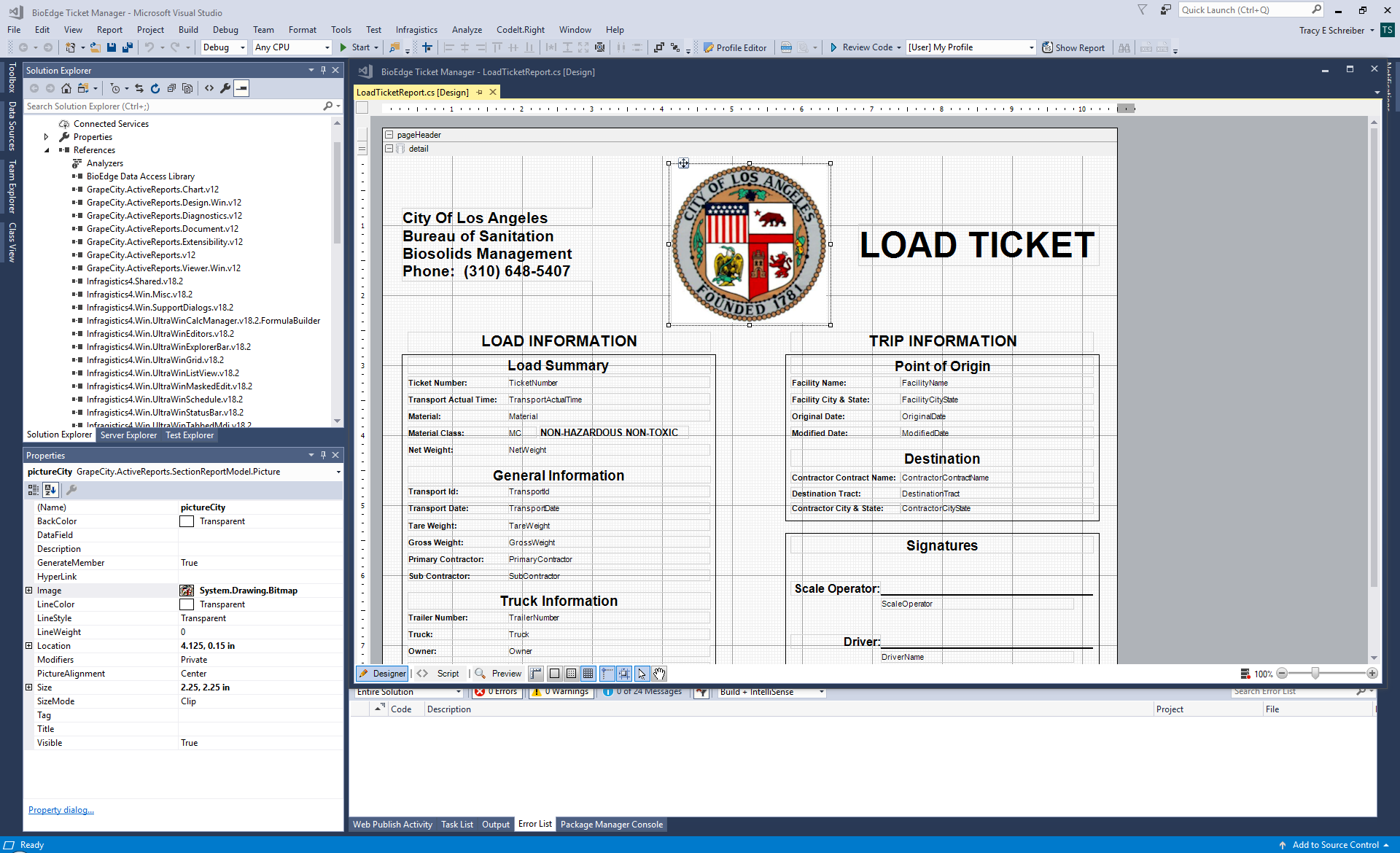

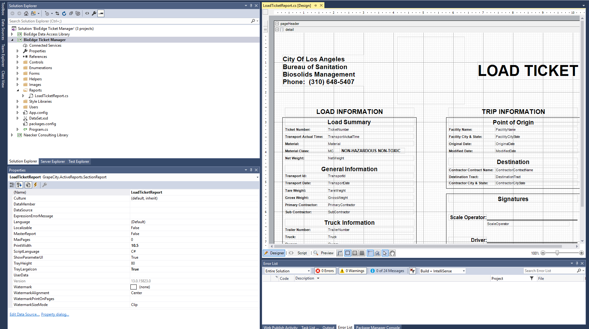

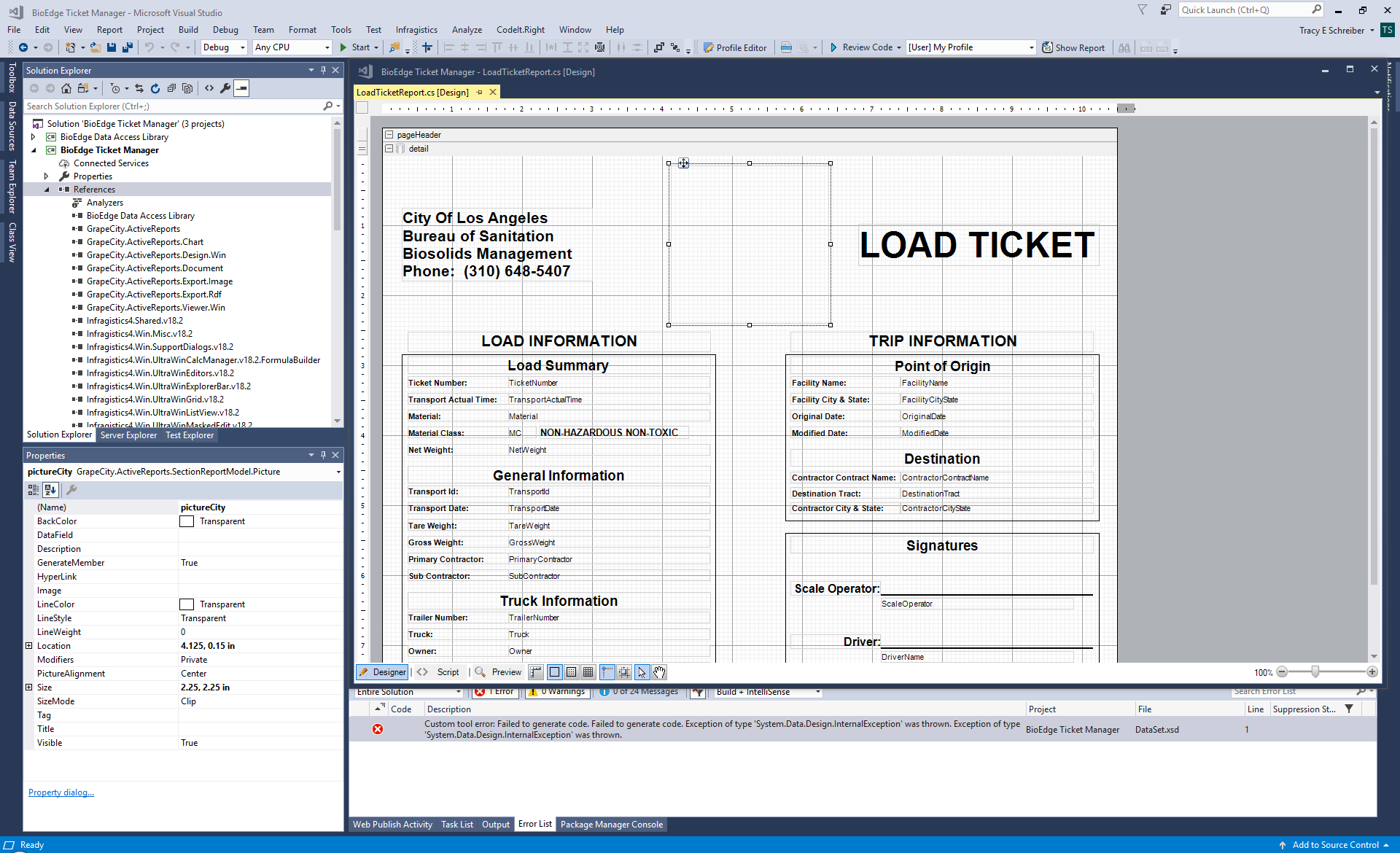

    I have an AR12 report that I tried upgrading to an AR13 report. In doing so, the Picture object on my report lost its image reference. I tried recreating the reference, but it didn’t work correctly. I have attached images showing my report before the upgrade and after the upgrade.

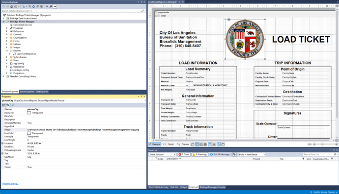

    I tried that. First, it does not embed the image in the report as it did in AR12. It just shows the directory link. I then tried saving the report and reopening the project. The image was gone again. Please see the image attachments.
