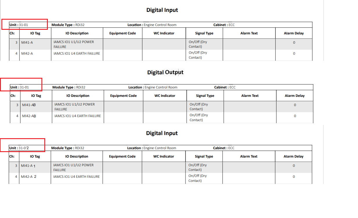

    if we have Unit value 31-01 in DigitalInput and 31-01 also in DigitalOutput
    so they will come one after other.
    If we also have Unit value 31-02 in DigitalInput then this record will come after 31-01 DigitalInput and 31 -01 DigitalOutput record.
    Kindly refer Sorted data.png for this (Expected Result).
    and we are getting data only for 31-01 and not in expected order.

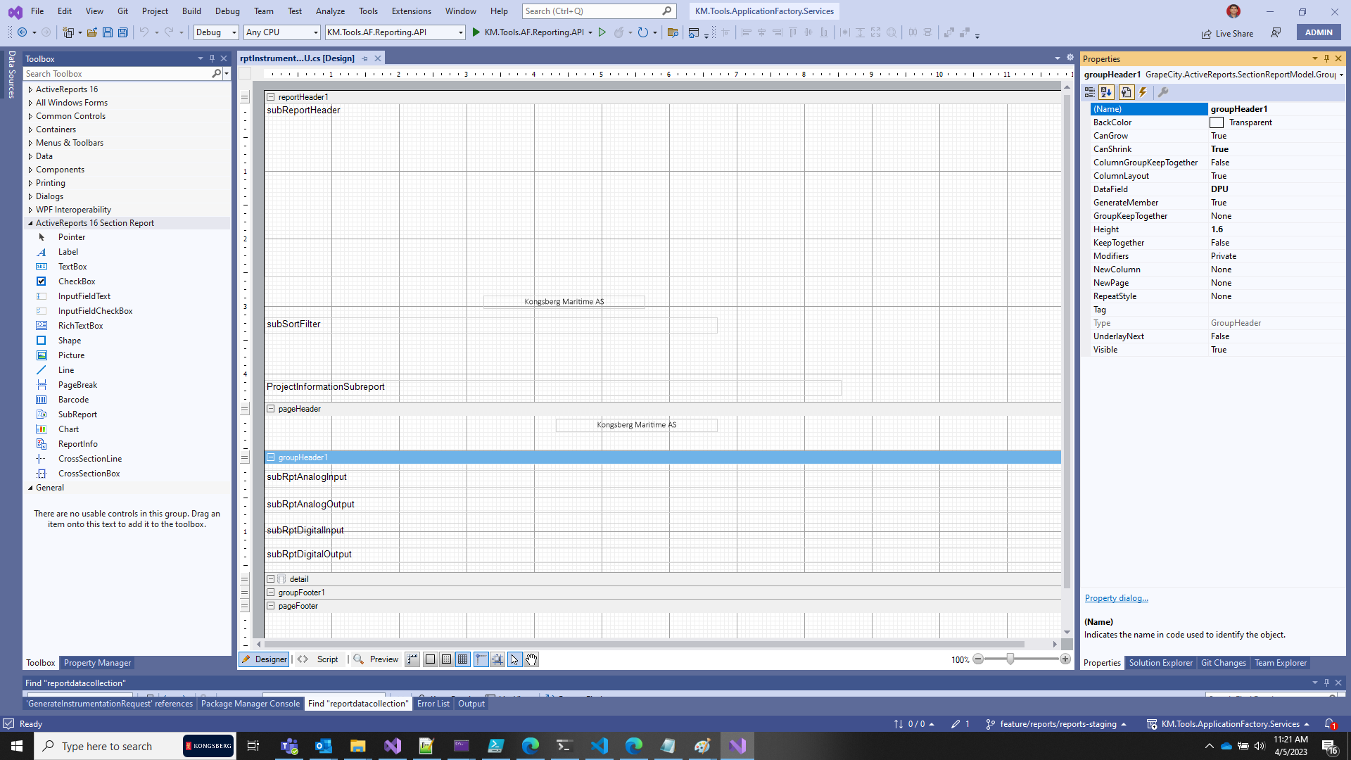

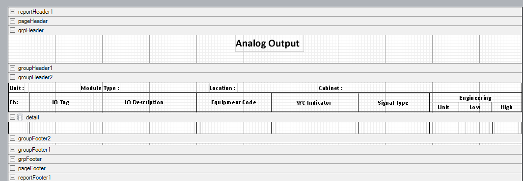

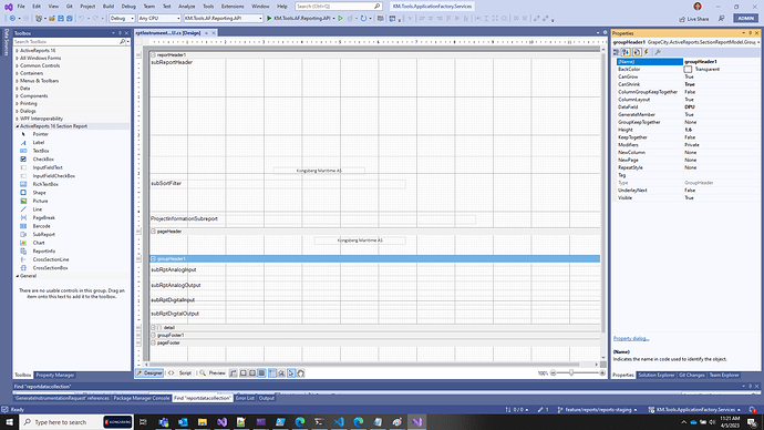

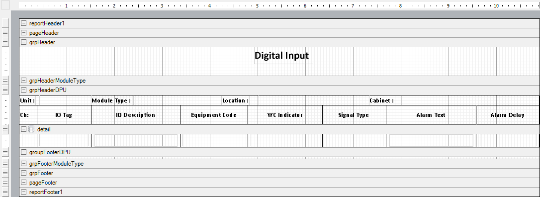

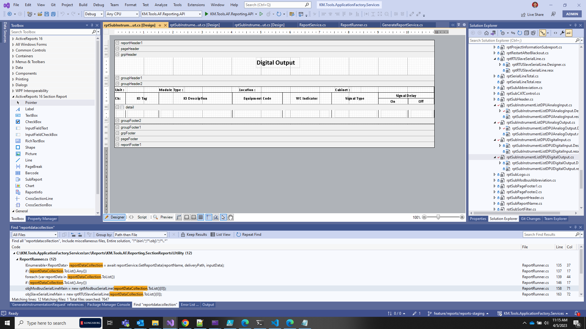

    Added mater report and subreports design view for reference

    Thanks for sharing the detailed explanation of your query. For your reference, as per your use case I have created a sample application and attached it along with the rendered report seems to be as expected.
    Please note I am filtering the Data for each sub report based on the current Fields[“Unit”] value in the main report.(see groupHeader1_Format in SectionReport1.cs script)

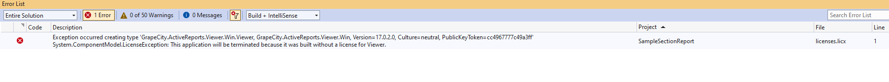

    We are getting compilation error as we don’t have same Active Reports version that you have used.
    Is it possible for you to provide sample example with AR 16 version.
    Error snapshot attached for reference.
