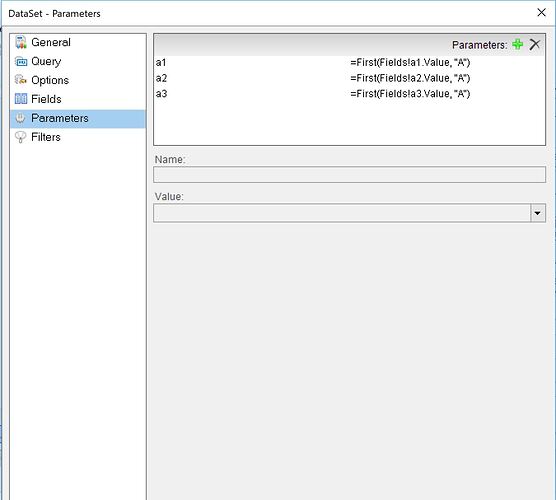

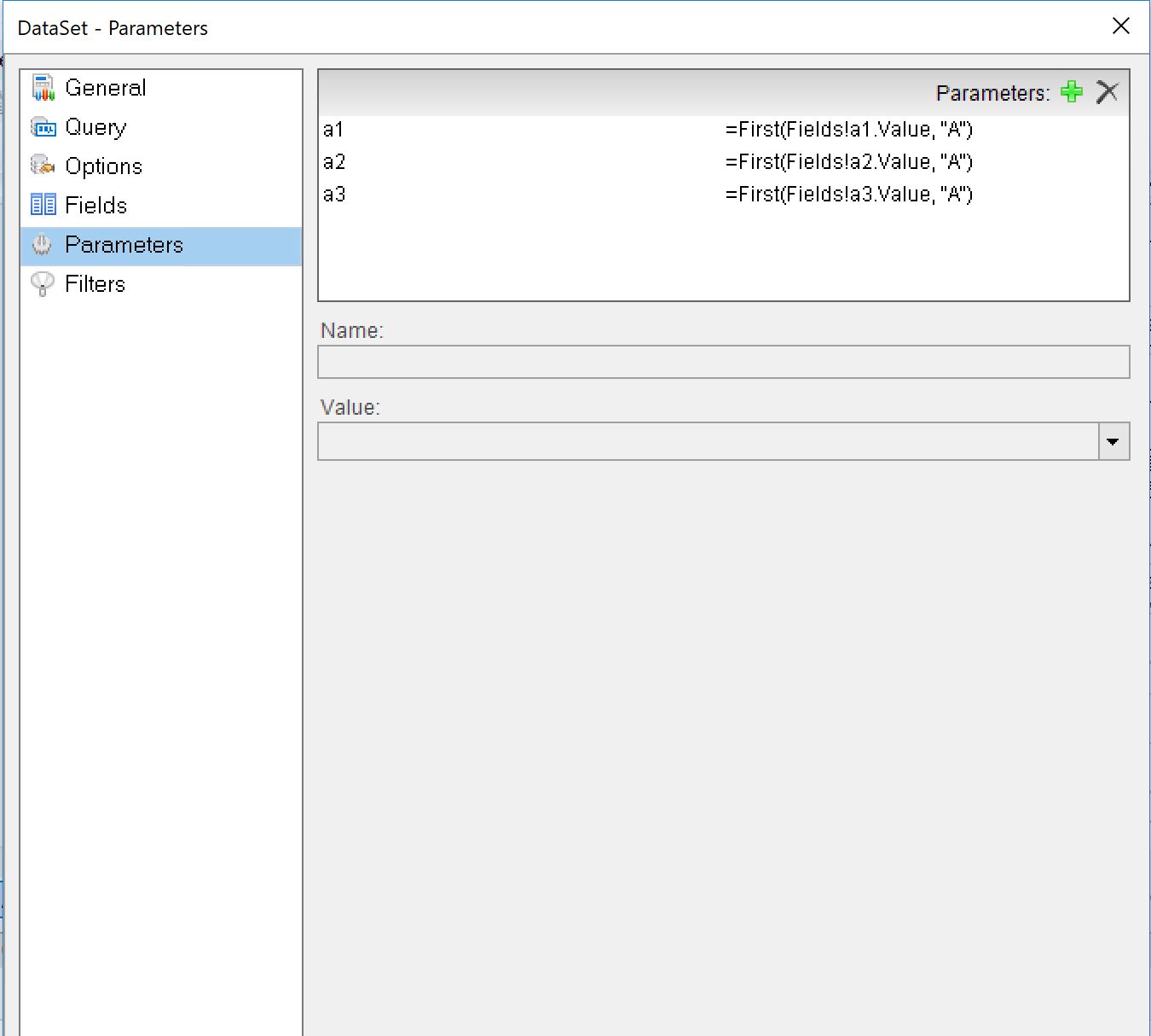

    Now, I have a DataSource using SQL Provider and 2 DataSets:
    • A using queryA with return Fields are a1, a2, a3
    • B using queryB.
      Can I Add parameters using a1, a2, a3 from DataSet A in queryB DataSet B.(Please view image below to more details)
      Thank you very much.

  • Posted 6 July 2021, 1:36 am EST
    You can hide the parameter and set the default value of parameter to value of the DataSet1. Please refer to the attached report for implementing the same.
    Mohitrpt_Cas.zip
  • Posted 6 July 2021, 3:43 am EST
    Dear mohitg
    Your answer help me very much.
