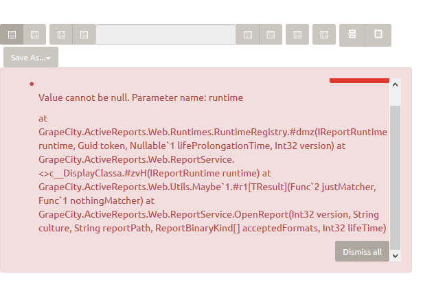

    Trying to run report using HTML5 Viewer (v12.1.12924.0). Getting following error when we execute report (development environment). Web service is executed without any errors.
    Value cannot be null. Parameter name: runtime
    at GrapeCity.ActiveReports.Web.Runtimes.RuntimeRegistry.#dmz(IReportRuntime runtime, Guid token, Nullable
    1 lifeProlongationTime, Int32 version) at GrapeCity.ActiveReports.Web.ReportService.<>c__DisplayClassa.#zvH(IReportRuntime runtime) at GrapeCity.ActiveReports.Web.Utils.Maybe
    1.#r1[TResult](Func
    2 justMatcher, Func
    1 nothingMatcher) at GrapeCity.ActiveReports.Web.ReportService.OpenReport(Int32 version, String culture, String reportPath, ReportBinaryKind acceptedFormats, Int32 lifeTime)
