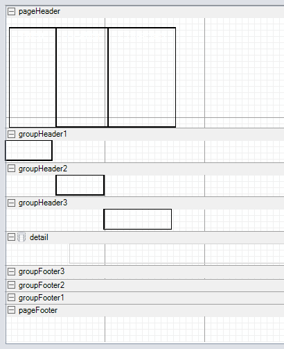

    This is probably (hopefully) a simple thing. I have a section report designed like so, with three column groups and a detail section that is dynamically generated in code. Here is the design window:

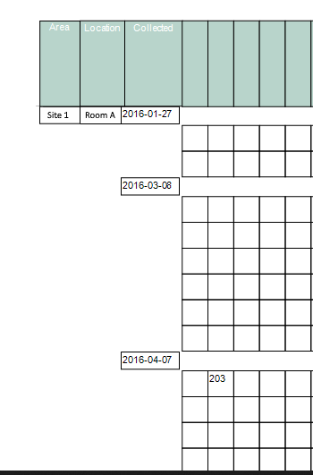

    The rendered report looks like so:

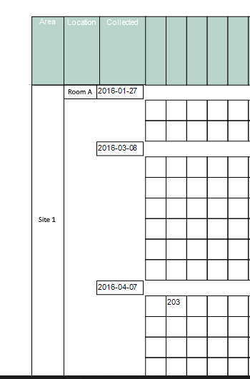

    I would like the first data cell, “Site 1”, to expand the complete height of all the rows in that group (as well as the other two grouped columns):

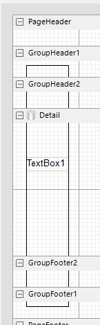

    There is no direct way to achieve your requirement. Can you add the “CrossSectionBox” in the GroupHeader1 and put the TextBox site inside the CrossSectionBox as shown in the Image.
    Hope it helps.
  • Posted 22 January 2021, 12:47 pm EST
    Brilliant! The CrossSectionBox worked perfectly. You are my Favorite Person of the Day. Thank you!
