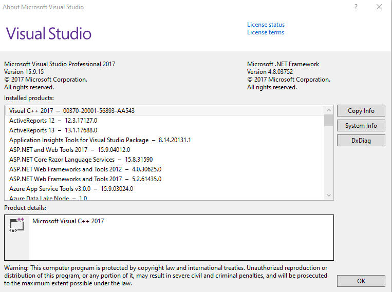

  • Posted 29 August 2019, 4:47 am EST - Updated 30 September 2022, 5:35 pm EST
    Hello Brian,
    No, you don’t need to deactivate the AR12 license before uninstalling AR. Also, I have checked at my end after updating the VS to the latest version 15.9.5 and uninstalling and reinstalling the AR12. I am able to see the AR template in my VS 2017 Pro. Please refer to the attached image.

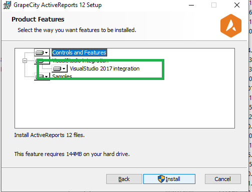

    Also, Make sure that you have VS option is checked at the time of installation. For more information, refer to the attached image.
  • Posted 29 August 2019, 11:41 am EST
    Mr Mohitg,
    I seems to have worked.
    Thank you
