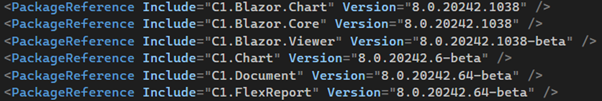

    I have created a report with 2 charts and it is rendering correctly in FlexReport Designer but when I try to load it in FlexViewer in my application I get the error “Could not load field of type [FlexChartField], fields of this type may not be supported in this edition of FlexReport.”. I have installed FlexReport NuGet package for Blazor. I have latest version of all required packages. How can I resolve this issue?

    Regarding the behaviour you mentioned while loading the FlexReport in the FlexViewer, I was able to replicate it with the latest version of C1 Library. I have escalated this to the relevant development team for further investigation. The internal tracking ID for this issue is C1XAML-37836.

    The developers have mentioned that the FlexChart fields are not supported now, but they will be supported in the next major release 2025V1. The ETA for the 2025V1 release is May 30, 2025.
