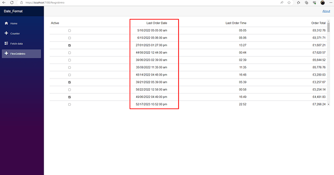

    I tested the Column Format at my end and it seems to be working fine at my end. The format depends on the culture localization. Please make sure of the following two things:
    1. You are using the GridDataTimeColumn when defining the column of the FlexGrid.
    <GridDateTimeColumn Binding="LastOrderDate" Format="m/dd/yyyy hh:mm:ss tt"
                                Mode="GridDateTimeColumnMode.Date" MinWidth="160" Width="GridLength.Star"
                                HorizontalAlignment="C1HorizontalAlignment.Right"
                                HeaderHorizontalAlignment="C1HorizontalAlignment.Right" />
    1. You are adding the culture supporting the format (applied in the Program.cs file).
    // Allowed using of date, number formats for all available cultures.
    var allCultures = CultureInfo.GetCultures(CultureTypes.AllCultures).Select(c => c.Name).ToArray();
    var localizationOptions = new RequestLocalizationOptions()
        .AddSupportedCultures(allCultures)
        .AddSupportedUICultures(allCultures)
        .SetDefaultCulture("en");
    app.UseRequestLocalization(localizationOptions);
