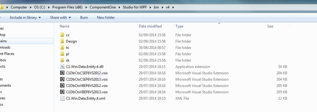

    Hi, I have this issue and have followed the above instructions but VS2012 can’t see anything to add from the C1.Win.Data.Entity.4.dll (attach1). Inb fact the folder looks a bit sparse (attach2). I can use and existing WPF project and see the tools etc, but if I do a new project, then things may get tricky…!

    It seems that you are using entity framework and for this, you could find the “C1.Win.Data.Entity.4.dll” from below location:
    C:\Program Files\ComponentOne\Studio for WinForms\bin\v4
    And apologies for the broken link, the new link for latest C1WPFLibrary build is: http://prerelease.componentone.com/dotnet40/c1wpflibrary/2014-t3/
    Please test your case with the provided dlls and let me know if it works for you.
