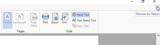

    Ok, I’ve managed to make some progress with the c1flexviewer.
    But when i add this object to a c1ribbonform, the c1flexviewer object overlays the form minimize/maximize area, being on top of them.
    Check the attached image, any idea why?
    See in the top right position, the object ontop of the form
  • Posted 13 February 2019, 6:15 am EST
    Thank you for sharing the image.
    I would like to inform you that this is the expected behavior. C1FlexViewer contains C1Ribbon control that is integrated with the title bar of the owner C1RibbonForm.
    If you wish to prevent integration of the form header with C1FlexViewer, you may add a Panel control to the Form, then instead of adding C1FlexViewer to C1RibbonForm directly, add it to Panel’s Controls collection.
