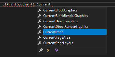

    The Y point for an object rendered through C1PrintDocument can be obtained using this code:
     Dim yval As Integer = CType(c1PrintDocument1.Body.Children(1).Y,Integer)
    Likewise, for the current object, you can use any of the properties shown in the screenshot below and then obtain the corresponding Y point.
    Unfortunately, there is no other way to do so.
    Hope it helps.
