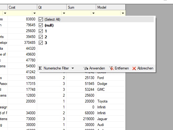

Posted 2 September 2021, 2:39 am EST - Updated 4 October 2022, 7:44 am EST
thanks for the reply but i mean the buttons(normally hide by the arrow) in the dropdown as shown i the picture. menu.

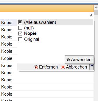

Posted 2 September 2021, 6:57 am EST - Updated 4 October 2022, 7:44 am EST
We do not see this behavior at our end. Please refer to the image attached.
Could you please let us know the version of C1 you are using or any other settings related to the filter that you might have applied?

Posted 28 September 2021, 8:21 am EST
I have found out why my filter hid the anwenden button. This is the case when I apply filter on the column via code. The flexgird version is 4.0.20212.513
Posted 30 September 2021, 1:12 am EST
You might have used ValueFilter or ConditionFiter, the UI shown is also according to the filter applied to the column. If you want the UI to allow both filter then we suggest you use the ColumnFilter to apply filter to column by code.
