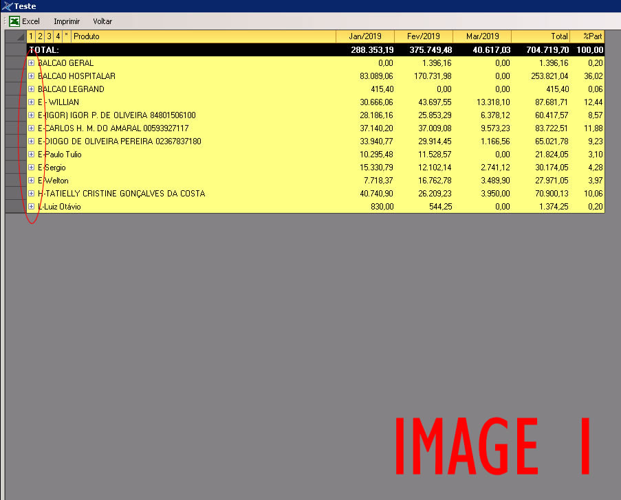

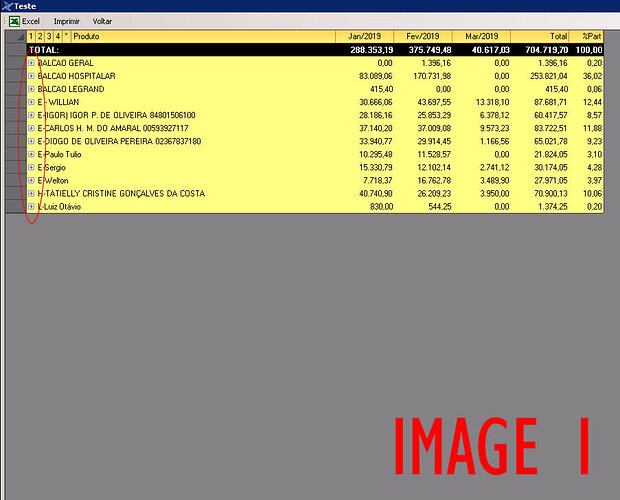

    I need to have my sub-levels come with + CLOSED as shown in figure IMAGE1

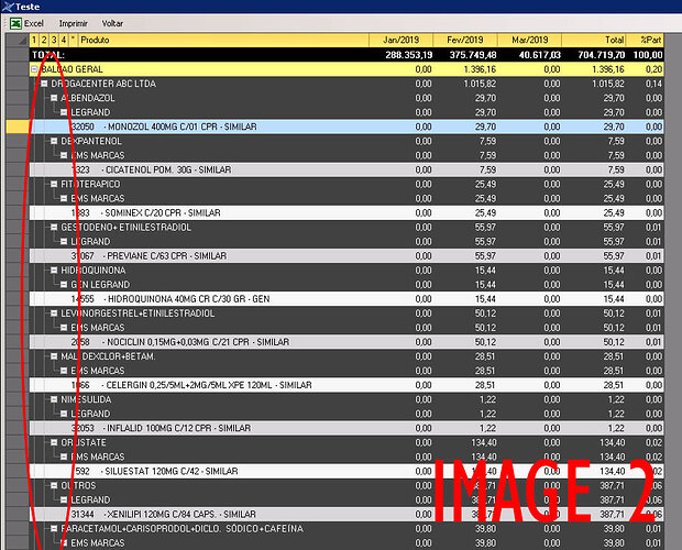

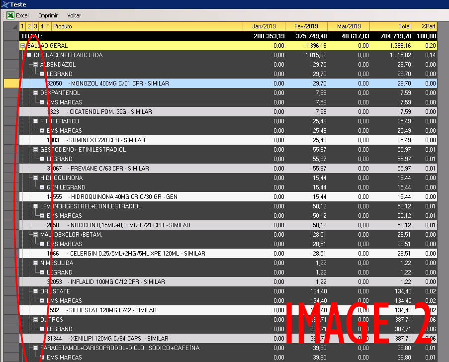

    this makes me the first level come closed, when I click on the +, the sub-levels come all open, I needed them to come all closed, as the user wishes, it opens.

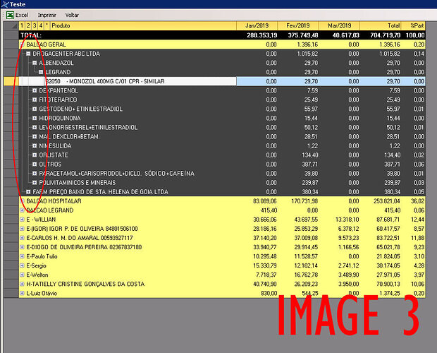

    In IMAGE 2 it shows how it came open, and IMAGE 3 shows how it should be.
