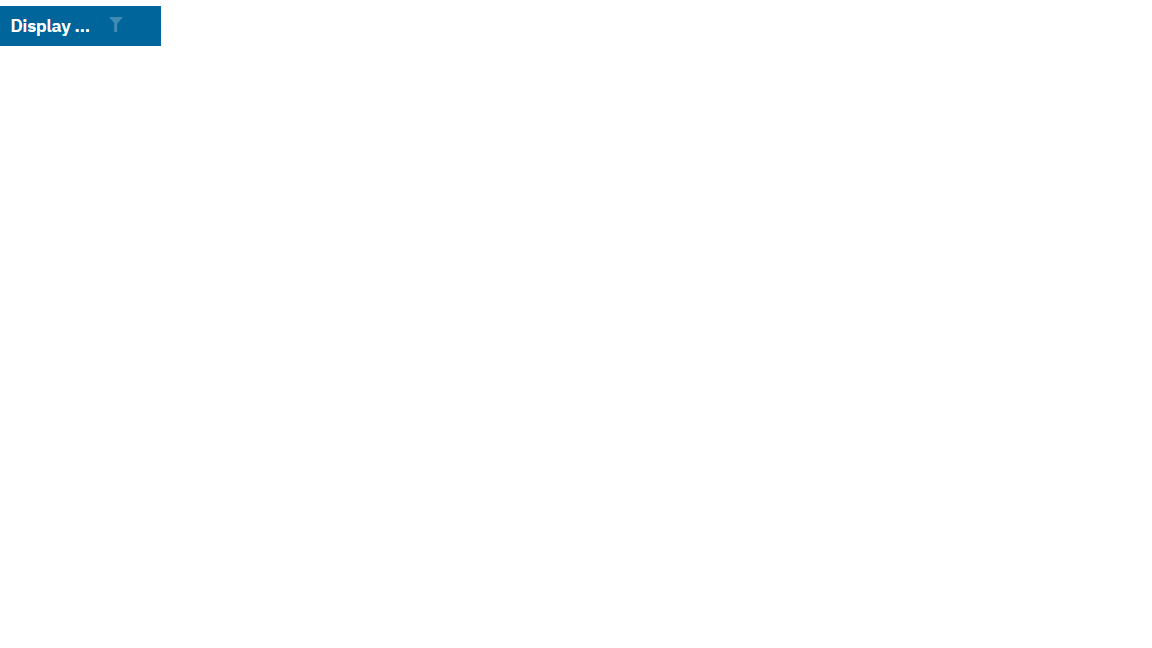

  • Posted 3 October 2022, 7:25 am EST - Updated 4 October 2022, 7:38 am EST
    Please find below the 2 scenarios where
    1. Valid filterText is entered i.e. the value is available in the column:
      filterText: abc
      Refer img: valid filter- icon focus.png
      Observation: Filter icon is highlighted in case of filtered data present
    2.Invalid filterText - value not available in the column.
    filterText : pqr
    Refer img: invalif-filter value.png
    Observation: Filter icon remains faded in case of no results matching the filterText.
    Note: Client side filters are used to match the filterText with row values,
    Thanks in Advance.
