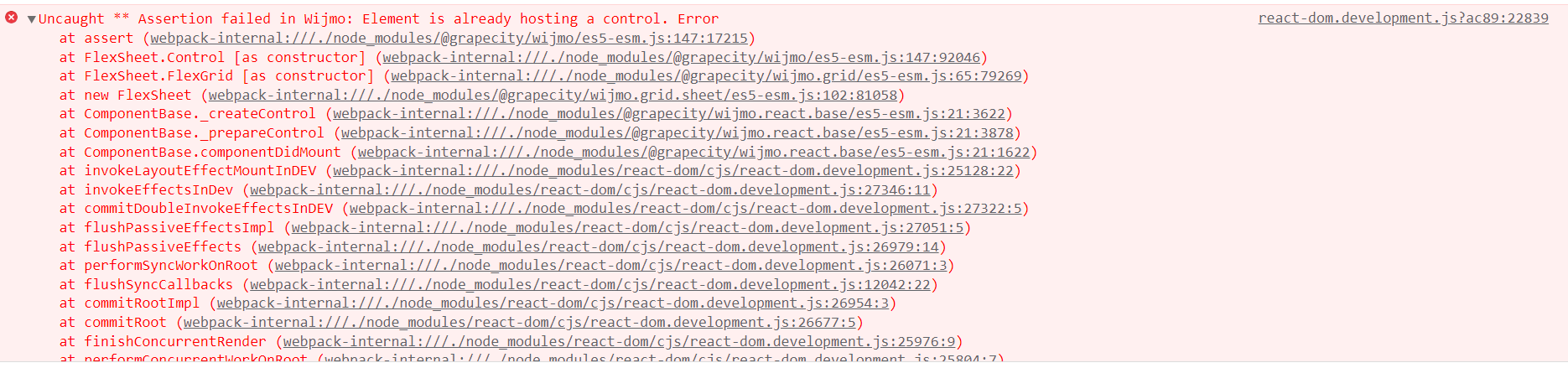

    I’m using flexsheet in our project. Everything was fine until we thought of upgrading react version from 17.0.2 to 18.2.0.
    I’ve started getting error saying - Uncaught ** Assertion failed in Wijmo: Element is already hosting a control.
    Grid/flesheet is not even being rendered error get throws from initializeFlexSheet function.
    flex.deferUpdate(() => {
          const grid = new wjGrid.FlexGrid(document.createElement('div'), {
            itemsSource: data,
            columns: getColumns(),
          flex.addBoundSheet('PriceAssessment', data, 0, grid);
          data.trackChanges = true;
          flex._contextMenu.show = () => false;
    can someone please help, We are stuck on this from last few days.

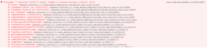

  • Posted 15 September 2022, 6:06 am EST
    Versions of packages that I’m using are
        "@grapecity/wijmo.grid": "^5.20221.857",
        "@grapecity/wijmo.grid.xlsx": "^5.20221.857",
        "@grapecity/wijmo.react.grid.sheet": "^5.20221.857",
    import { FlexSheet } from '@grapecity/wijmo.react.grid.sheet';
