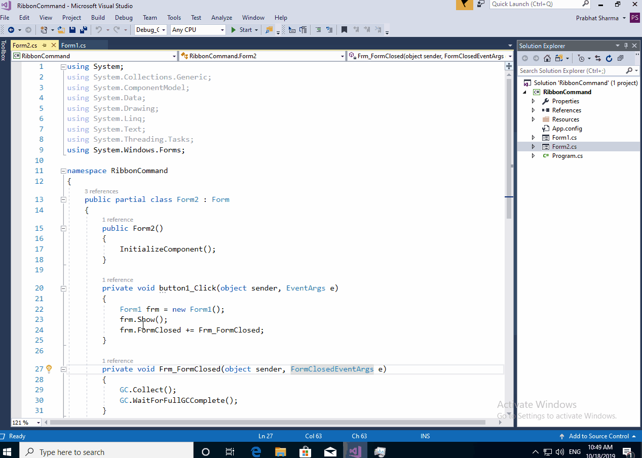

    As I said earlier whenever new object is instantiated, user objects has been created for that object.
    I updated my application as per your changes in Form1.cs file.
    I too can replicate the issue in the 4.0.20172.271 builds that user object is increasing continuously but on checking with latest builds 4.0.20192.375 that user object value remains between 32-33 in the attached application by following the previously given steps. Please see the attached GIF for reference.
    You can download the latest builds from the given link :
    https://www.grapecity.com/download/componentone-studio
