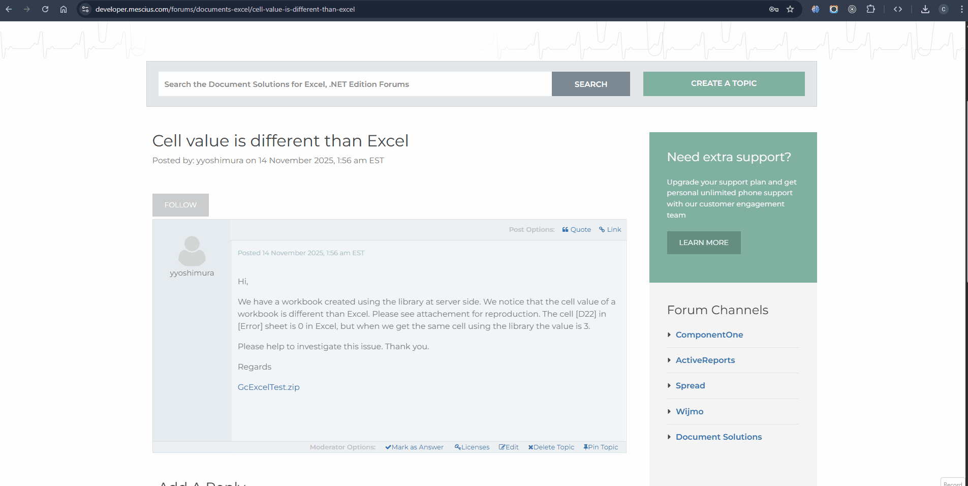

Cell value is different than Excel
Posted by: yyoshimura on 14 November 2025, 1:56 am EST
  • Posted 14 November 2025, 1:56 am EST
    We have a workbook created using the library at server side. We notice that the cell value of a workbook is different than Excel. Please see attachement for reproduction. The cell [D22] in [Error] sheet is 0 in Excel, but when we get the same cell using the library the value is 3.
    Please help to investigate this issue. Thank you.

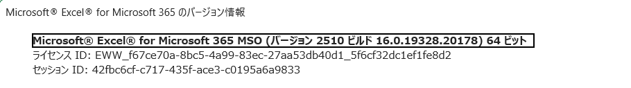

  • Posted 16 November 2025, 9:42 pm EST - Updated 16 November 2025, 9:48 pm EST
    Thank you for the explanation. At our end the result is different in Excel with GcExcel library. Please see attachment for details. The C4 cell contains “OK” and result in D22 is 0.
    Our Excel version is in Japanese and details is as following.
