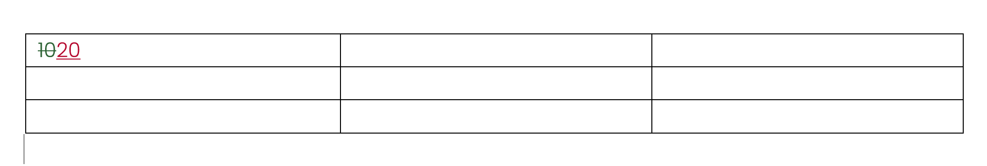

    When we want to display the changes - Let us say a cell had value 10 , this was changed 20 then we would show it as in the screenshot attached,
    is there someway i can show two values with different styles in a cell, is there a notion of text runs inside cells which can have different styles in DSExcel? which can be used to drive different styles and display them in spreadjs

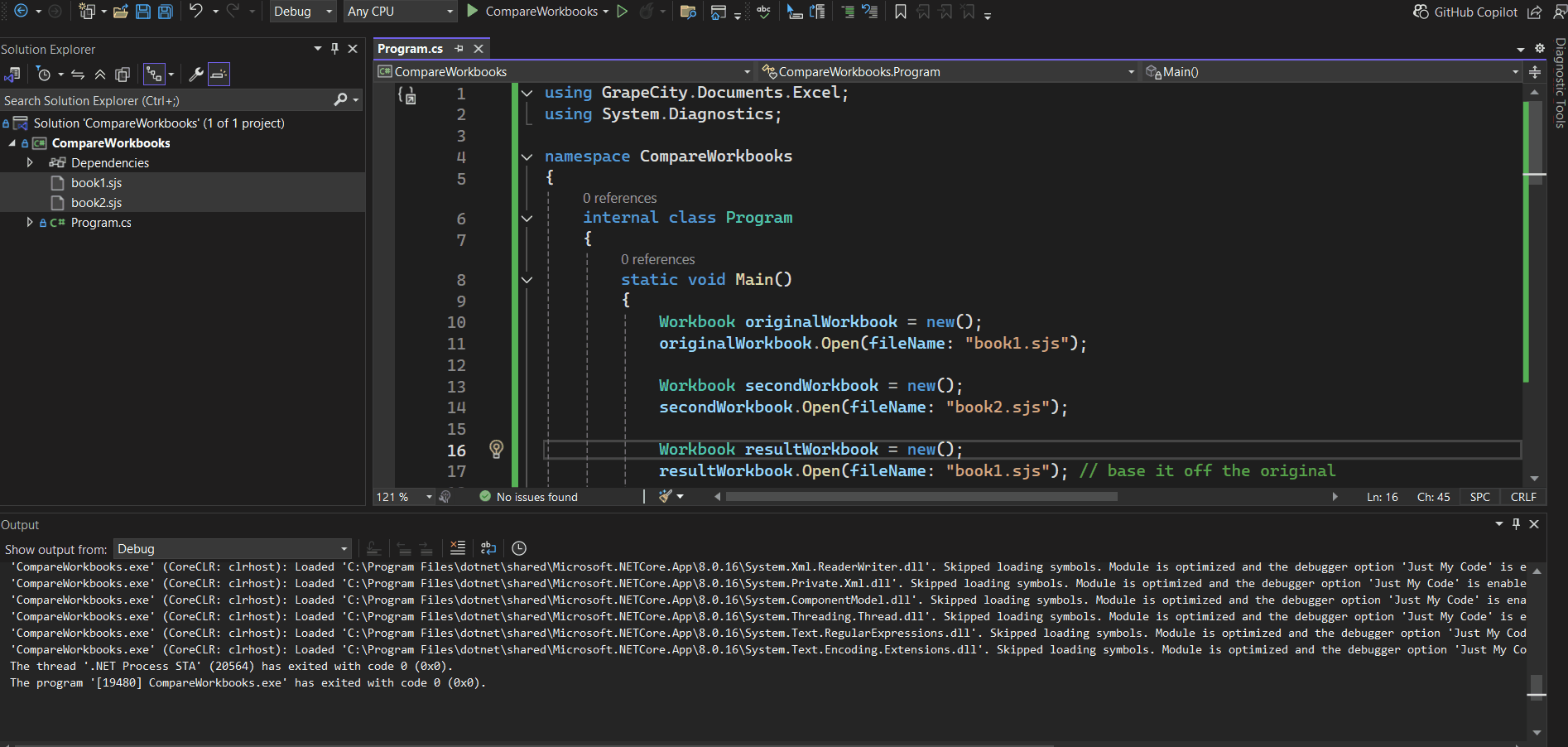

    However, we recommend you write your custom logic for comparing two workbooks in DsExcel.NET as the comparison logic can be a bit too broad and you can write the logic specific to your comparison requirements. You can refer to the below code snippet that illustrates the comparison of two workbooks and rewrite the cell text as per the screenshot:
    Workbook originalWorkbook = new();
    originalWorkbook.Open("book1.sjs");
    Workbook secondWorkbook = new();
    secondWorkbook.Open("book2.sjs");
    Workbook resultWorkbook = new();
    resultWorkbook.Open("book1.sjs"); // base it off the original
    for (int i = 0; i < originalWorkbook.Worksheets.Count; i++)
        IRange usedRange = originalWorkbook.Worksheets[i].GetUsedRange();
        for (int row = usedRange.Row; row <= usedRange.LastRow; row++)
            for (int col = usedRange.Column; col <= usedRange.LastColumn; col++)
                string originalText = originalWorkbook.Worksheets[i].Cells[row, col].Text;
                string newText = secondWorkbook.Worksheets[i].Cells[row, col].Text;
                if (!string.IsNullOrEmpty(originalText) && !string.Equals(originalText, newText))
                    IRange resultCell = resultWorkbook.Worksheets[i].Cells[row, col];
                    resultCell.Clear(); // clear existing content
                    IRichText richText = resultCell.RichText;
                    ITextRun oldRun = richText.Add(originalText);
                    oldRun.Font.Color = System.Drawing.Color.Green;
                    oldRun.Font.Strikethrough = true;
                    ITextRun newRun = richText.Add(newText);
                    newRun.Font.Color = System.Drawing.Color.Red;
                    newRun.Font.Underline = UnderlineType.Single;
    resultWorkbook.Save("book3.xlsx");
    You can further refer to the attached code sample that uses the above code snippet and generates the required results (see below).
