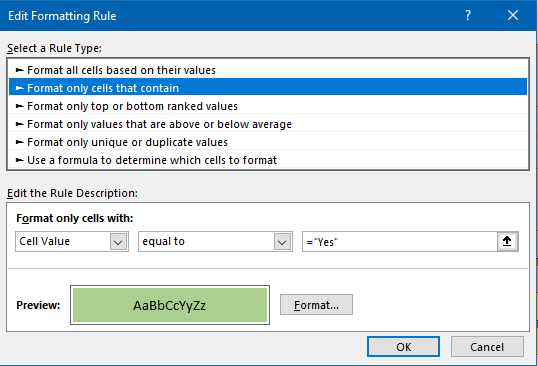

    Example of our style formats:

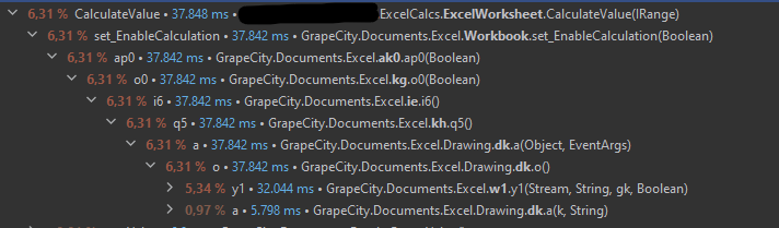

    After we run the ClearFormats() method for each of our cells, the set_EnableCalculation method takes ~3,7s.
    What makes us sceptical is that the method “PrintManager GetSize” needs 3,2s although we do not want to print anything but only calculate the formula of the cell.

    As per the developers, the PrintManager GetSize method would get the real font file and measure the content, so it would take some time. If you do not want to print anything, do not call it.

    We already figured out that this problem is related to the style formats that are used in our excel sheet.
    Do you need any more detailed information about these formatting rules? Or can we arrange a meeting with one of your developers?

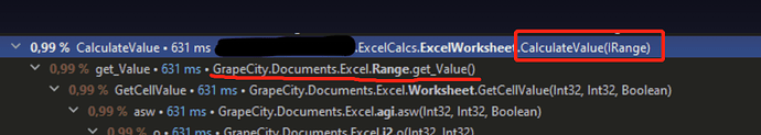

    here the performance stack trace of both versions:
    v5.0.5 :
    v4.2.6:

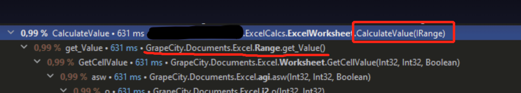

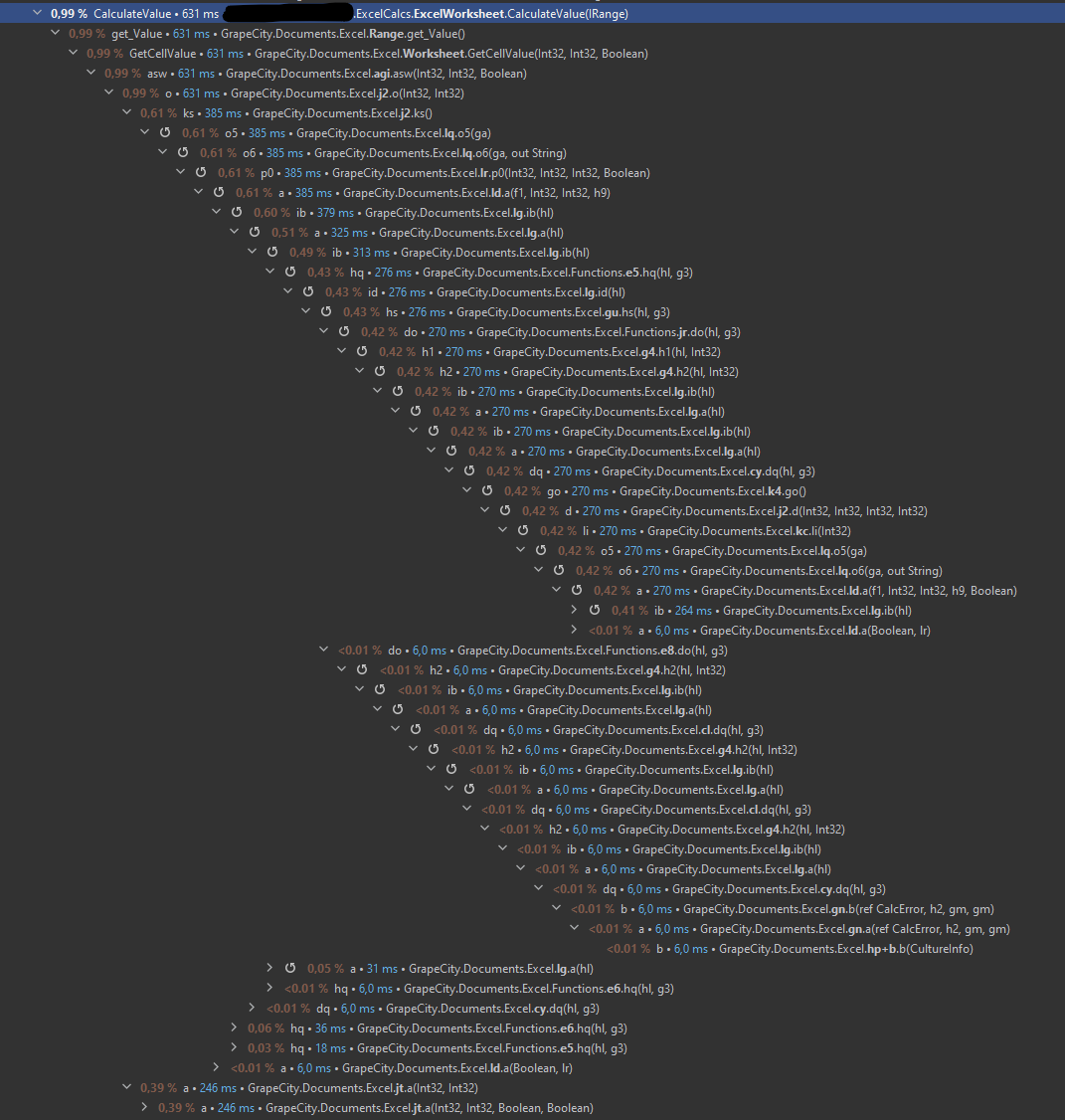

    The developers noticed the call stack is not the same between 4.2.6/5.0.5. It will be better if you use the exact same code to test the performance.
    5.0.5:
    4.2.6:
