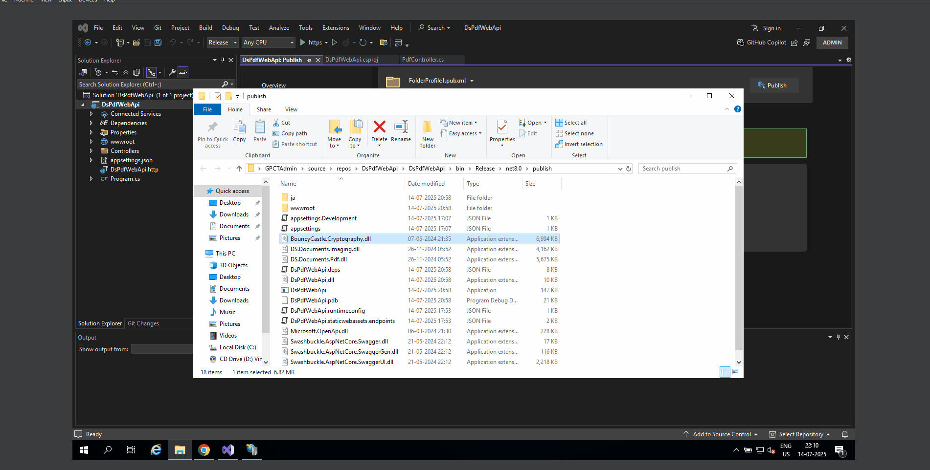

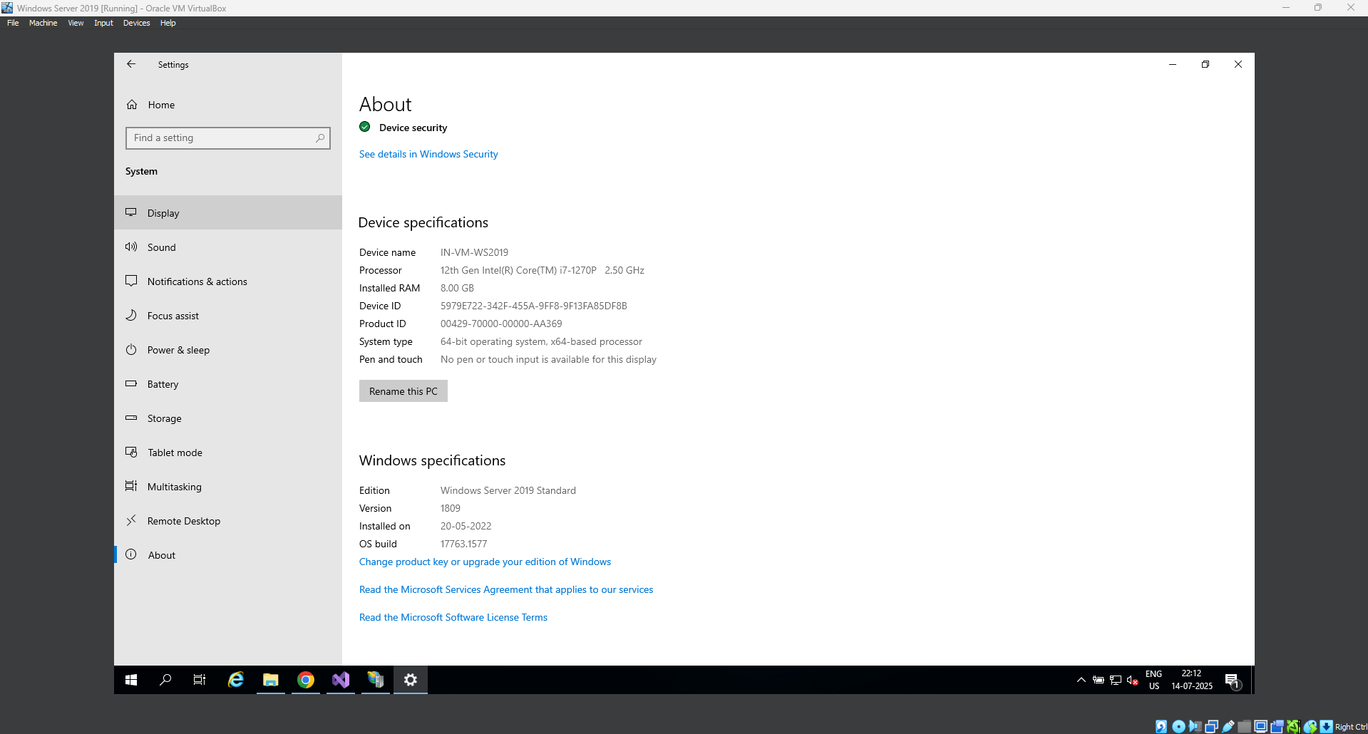

    To help us investigate further, we would need a minimal reproducible project or a sample deployment that triggers the exception on your client’s machine with the illustrative video recording. This will allow us to identify any environment-specific or deployment-specific issues on IIS.
    You can further refer to the attached sample application used to investigate the issue on our end, with the working screenshot and the system configurations.
    Attachment: DsPdfWebApi.zip
    Working:
    System Configurations:
