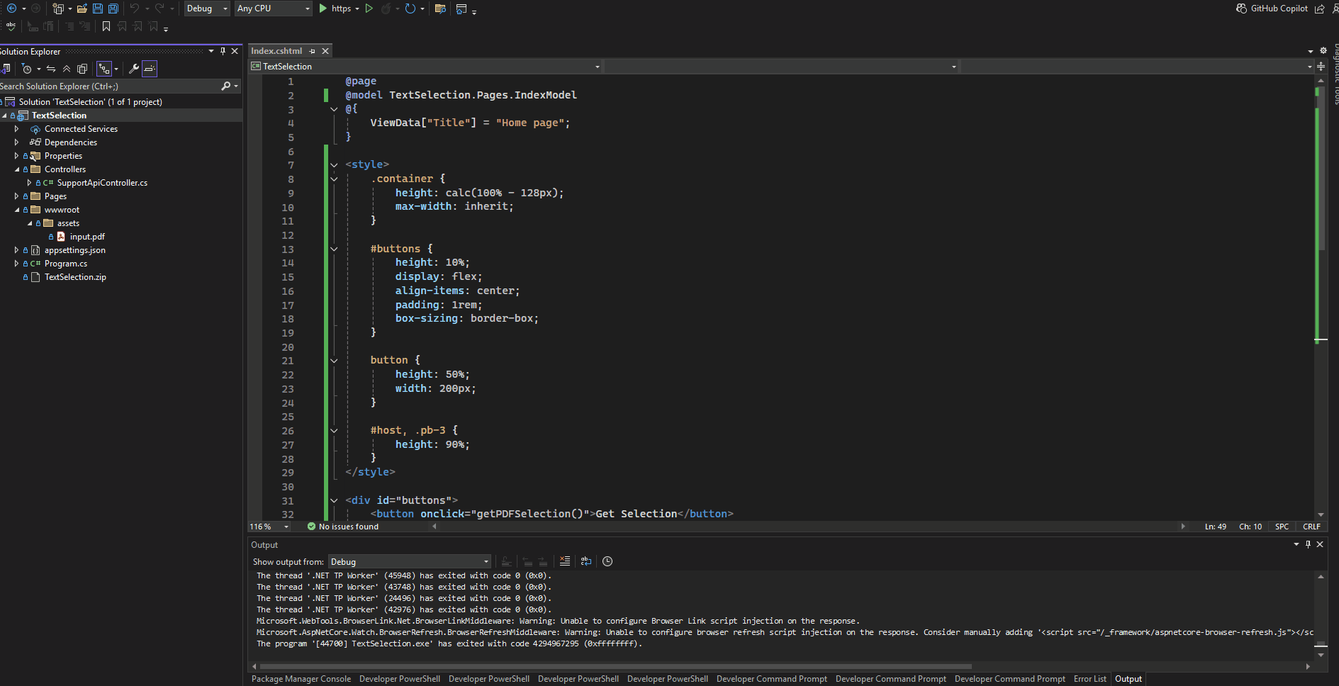

    In DsPdfViewer, the concept of start and end character indices does not directly apply like it would in plain-text editors, because PDF documents are not stored as linear text. Instead, selected text is based on visual regions (bounding rectangles) rather than index positions.
    However, it is possible to extract the visual region of the selected text using the viewer.selectionCopier object.
    <button onclick="getPDFSelection()">Get Selection</button>
    <div id="host"></div>
    <script>
        var viewer = new DsPdfViewer("#host");
        viewer.addDefaultPanels();
        function getPDFSelection() {
            console.log(viewer.getSelectedText()); // Get the selected text
            console.log(viewer.selectionCopier);   // Get the selected text information
    </script>
    So while you can’t get character-level start/end indices, you can identify exactly where the selection is visually on the PDF, which is how DsPdfViewer internally represents and processes selections.
    You can further refer to the attached sample that uses the above code snippet and gets the bounding rectangles containing the selected text (see below).
    Please let us know if you need any further guidance. If you could share more about your use case, we can provide further assistance tailored to your requirements.
    TextSelection.zip

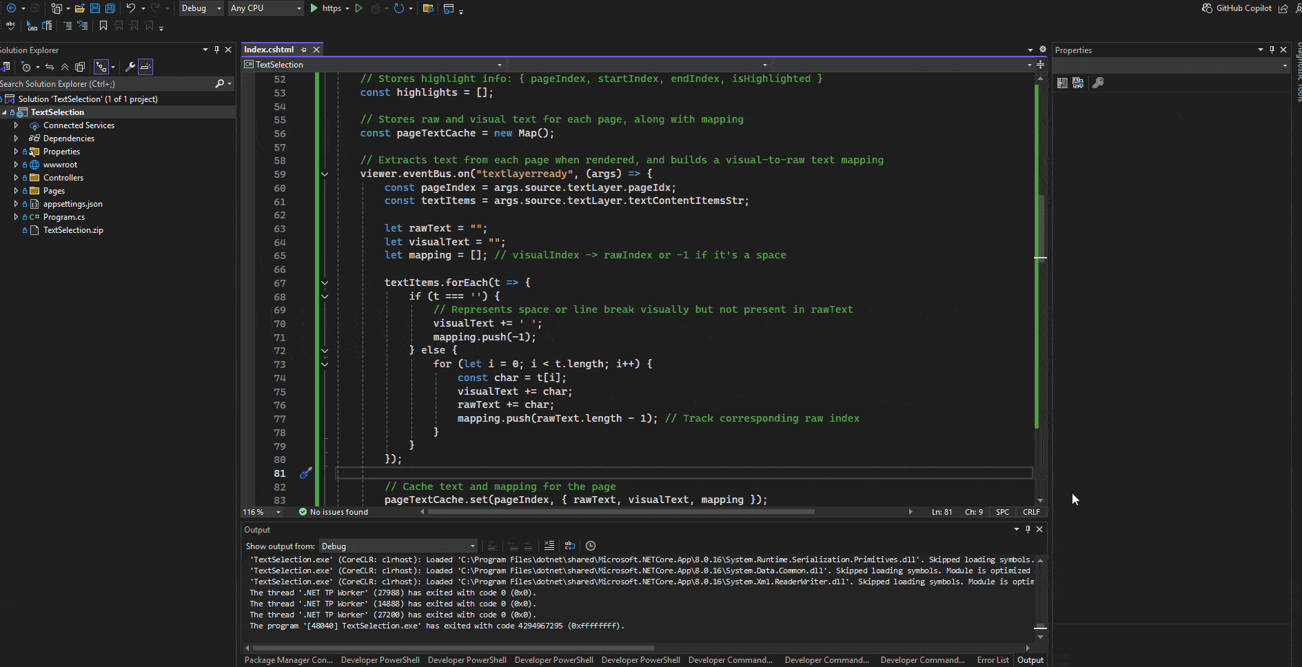

    Many thanks for your feedback. I was hoping to store the start and end index of the highlighted text so I could use the “highlightTextSegment” method to re-highlight text that had been previously stored. I want to store these highlighted text segments outside of the document. It is much more cumbersome to store all the bounding rectangles.
  • Posted 24 June 2025, 4:10 am EST - Updated 24 June 2025, 4:15 am EST
    Thanks for sharing your user story.
    While DsPdfViewer does not provide a direct method to retrieve the start and end indices of selected text, it is possible to extract them using the following approach:
    1. Listen to the textlayerready event and store the page index along with the full page text.
    2. When the user selects text, match the selection against the stored text.
    3. Determine and store the start and end indices of the selection within the page text.
    4. Use these indices with the highlightTextSegment() method to highlight the text accurately.
    Please refer to the attached sample, which demonstrates this approach and highlights the selected text as expected (see below).
    Please note that this is a proof-of-concept sample. If the same text appears multiple times on a page, additional logic may be required to compare the selection rectangles and accurately identify the intended text segment.
    Let us know if any further assistance is needed.
    Kind Regards,
    Chirag Gupta
    Attachment: TextSelection.zip
