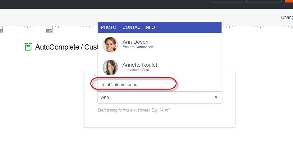

    may i know how to add foottemplate for Html.C1().AutoCompleteFor control? same as Kendo current support.
  • Posted 12 June 2018, 3:43 am EST
    i have tried GetFocus, LostFocus, ItemFormatter, Changing, Changed, all these function, but no one work perfect.
  • Posted 13 June 2018, 4:48 am EST
    To add footer for AutoComplete DropDown, the collectionChanged event should be handled for Control’s collectionView.
    Please refer to the attached sample for the same.
