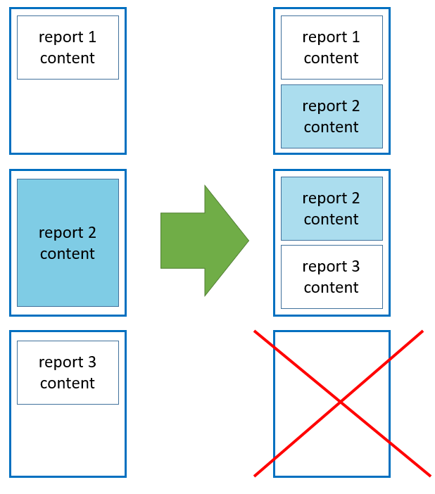

    I want to create a combined report (kind of report book) which contains multiple reports with different templates. Some reports are only single page static and some reports will have dynamic data spanning over many pages.
    As shown in the attachment I have a requirement where If a report takes only a half a page move the content of the second report to the first report’s page. Purpose is to save space.

    You may create a master report and add all the three report as SubReport. It will render the reports continuously.
    Please refer to the following documentation link:
    https://help.grapecity.com/componentone/NetHelp/FlexReport/webframe.html#SubreportField.html
