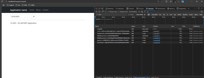

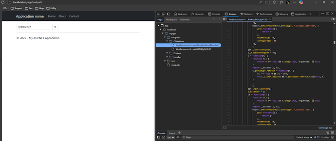

    To test your scenario, we created a virtual directory. (see virtualDirectory.png)
    Running the sample did not produce any issues—all network calls returned status 200, and the web resources were available at “./myapp/”. Please see the attached screenshots. (see networkTab.png and sourcesTab.png)

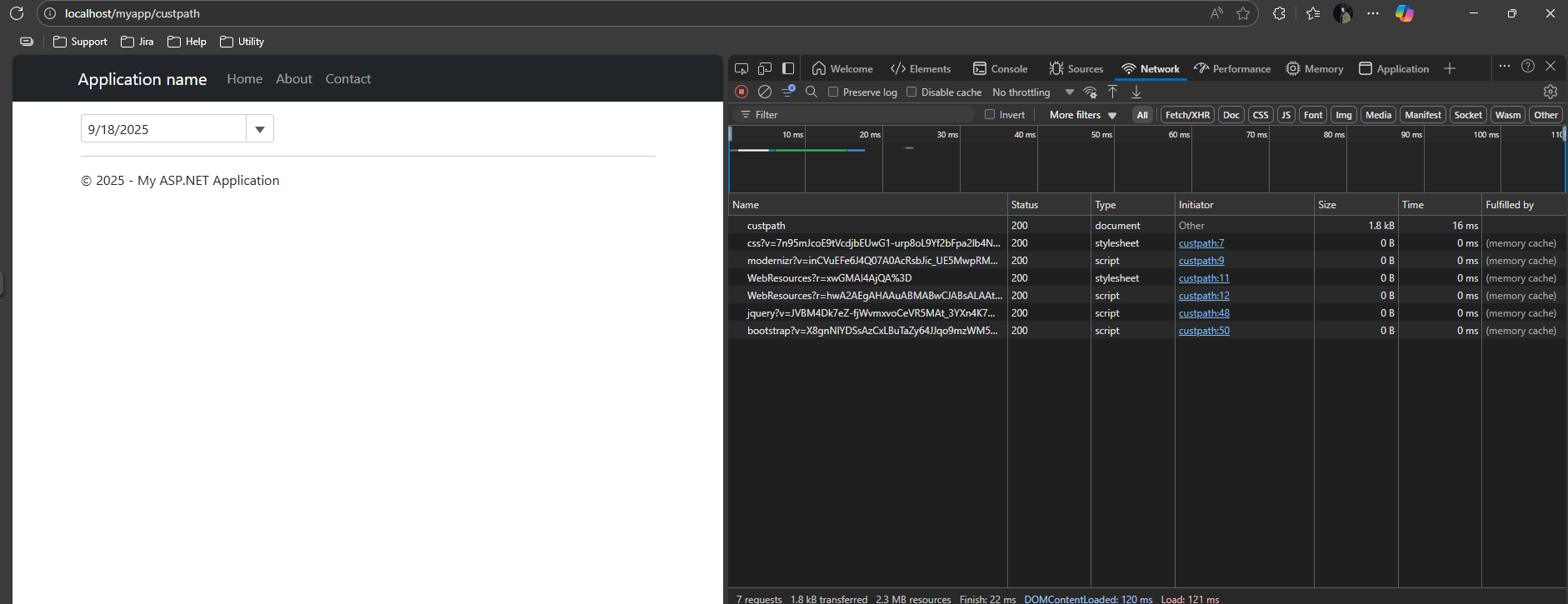

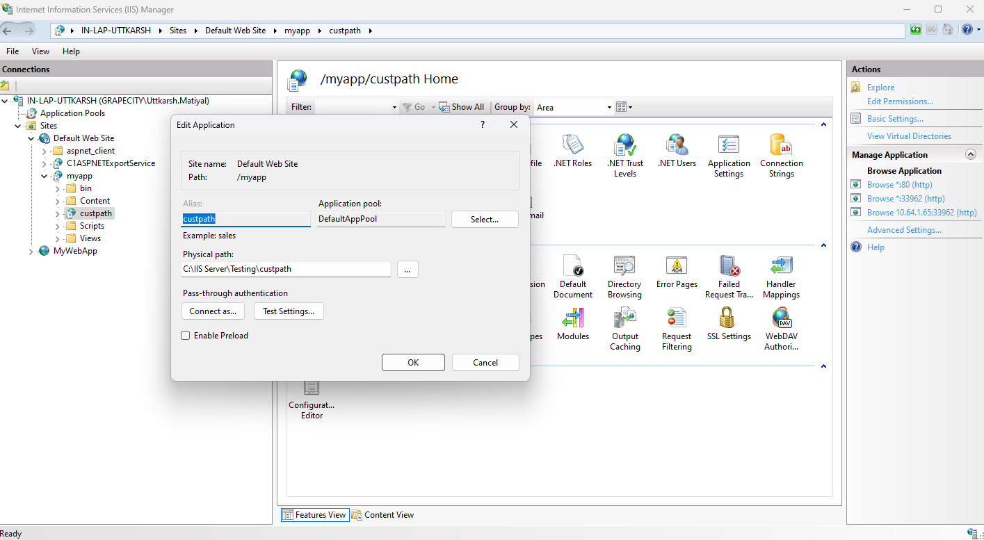

    To test the scenario, we published the app we attached in previous reply and hosted it on IIS. To simulate a nested path, we created an application under the Default Web Site named “myapp” and then added a child application under “myapp” named “custpath”. Please refer to the screenshot below:
    After this setup, we were able to access the application at http://localhost/myapp/custpath
    without any issues. The resources were loading correctly and located at: myapp/custpath/C1WebMvc/. Please see the attached screenshots for reference.
