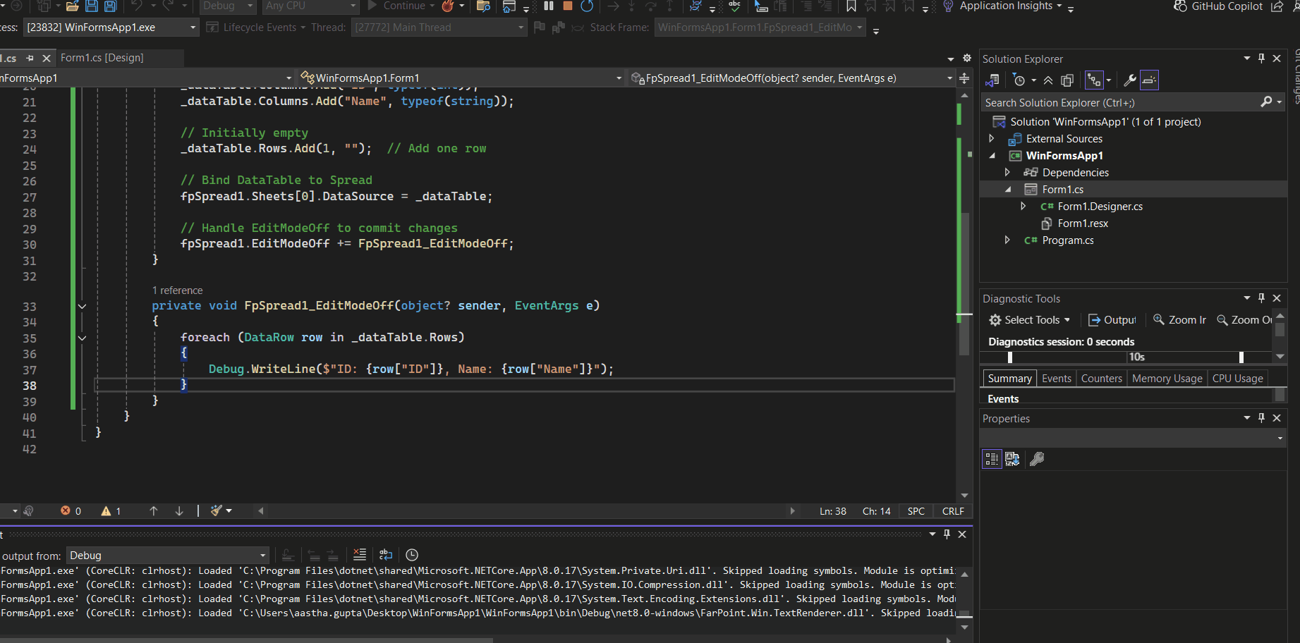

    We created a sample application based on the details provided by you. However, we could not replicate the behavior on our end. Kindly check the following GIF to see the behavior on our end:
    We kindly request you update the attached sample so that we can replicate the issue on our end and provide you with a more specific solution.
