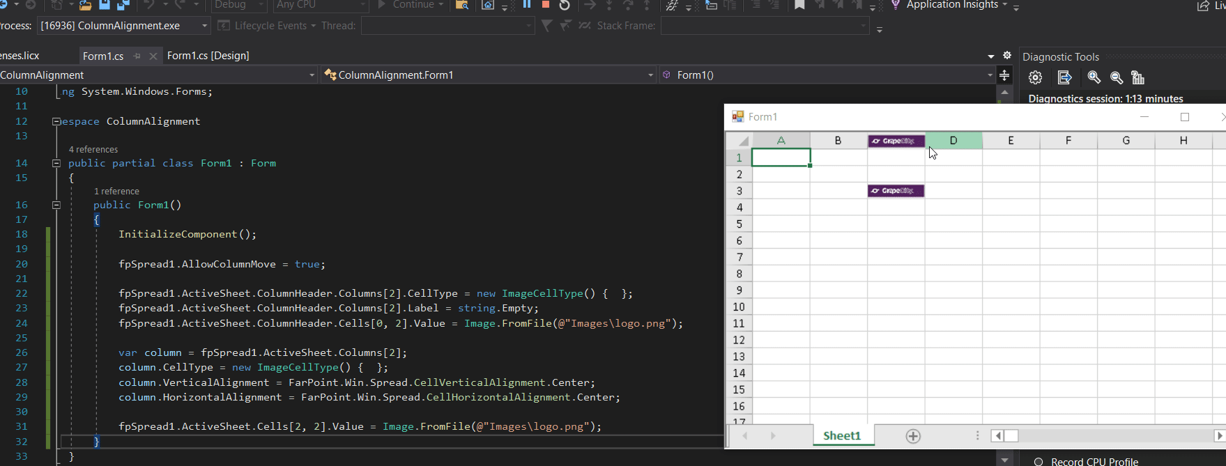

    The Alignment should remain same even after resizing/moving a column.
    I created a simple application using your code and I noticed no issues.
    Please see the attached GIF.
    Let me know if I’m missing anything to observe the issue you have described.
