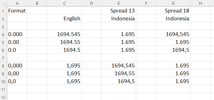

    Here are the collated results showing the formatted cells from 3 different runs. I’ve attached this as a png:

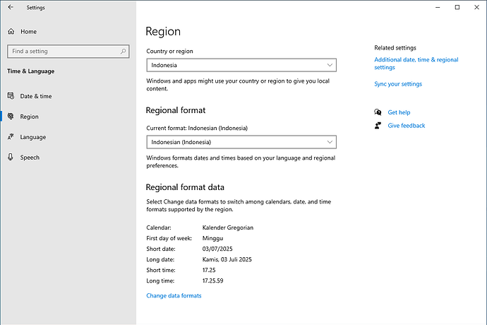

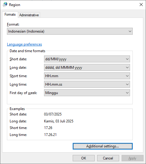

  • Posted 3 July 2025, 3:40 am EST - Updated 3 July 2025, 3:45 am EST
    The test system in question is Windows 10 and set for Indonesian (as we support customers in Indonesia).

  • Posted 18 July 2025, 5:12 am EST
    I can accept that the NumberFormat should be in English (different to Spread 13).
    However there is still a problem, the second line of the Excel demo displays “1694,55” for a format of “0.00”, but Spread 18 displays “1.695” for a format of “0.00” (refer to the table in my first post above).
    Can you ask the developers to explain the anomaly with 2 decimal places?

  • Posted 22 July 2025, 1:25 am EST
    Hello Peter,
    As per the team, “0,00” is not the correct number format for number groups at all. If you input that code to Excel, Excel will autocorrect it to “#,#00”.
    Spread doesn’t support the auto-correct number format feature. So, not all invalid number formats work with Spread.
    Please ensure a proper number format so that it works in both Spread and Excel.
