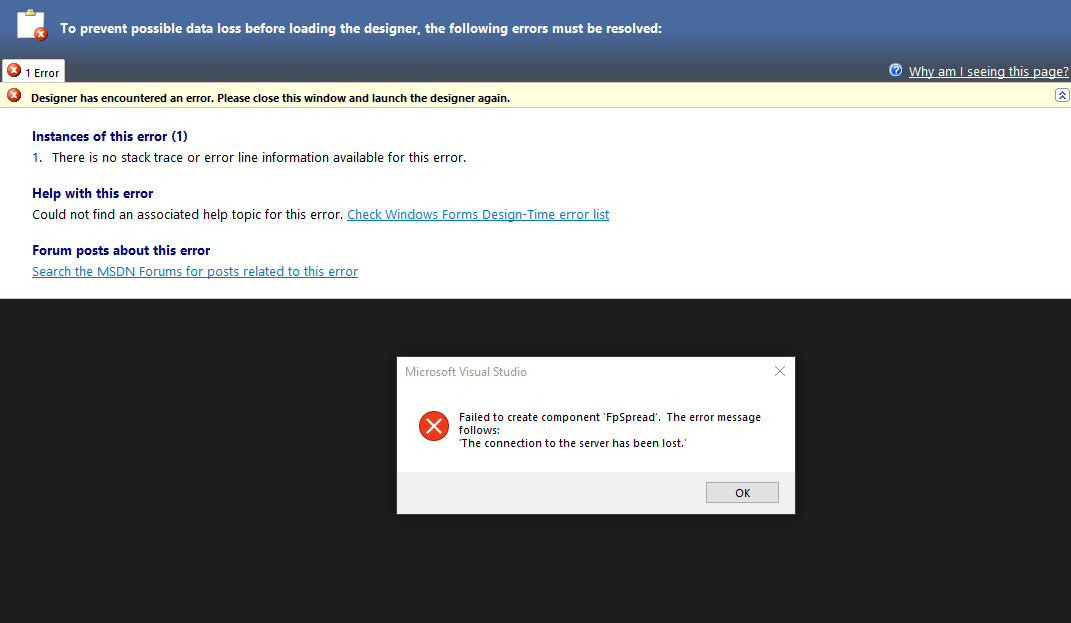

    I have installed the GrapeCity.Spread.WinForms NuGet , and in new project when I try to drag a FpSpread control to the form it says that license is not found and that connection to the server has been lost. I’m using Visual Studio 2019 Version 16.10.2 for Net Core 5.0 WinForms project.

    Hi Ivan,
    Sorry for the inconvenience. Spread. NET controls for .NET Core 3.1 and .NET 5 Windows Forms do not support design-time in Visual Studio like the full- framework Spread. NET 14 Windows Forms controls as mentioned in the blog here : https://www.grapecity.com/blogs/introducing-new-support-for-dotNET5-and-dotNET-core-3-1
    Our development team is working on providing design-time support for NET 5 and it will be provided in a later release.
