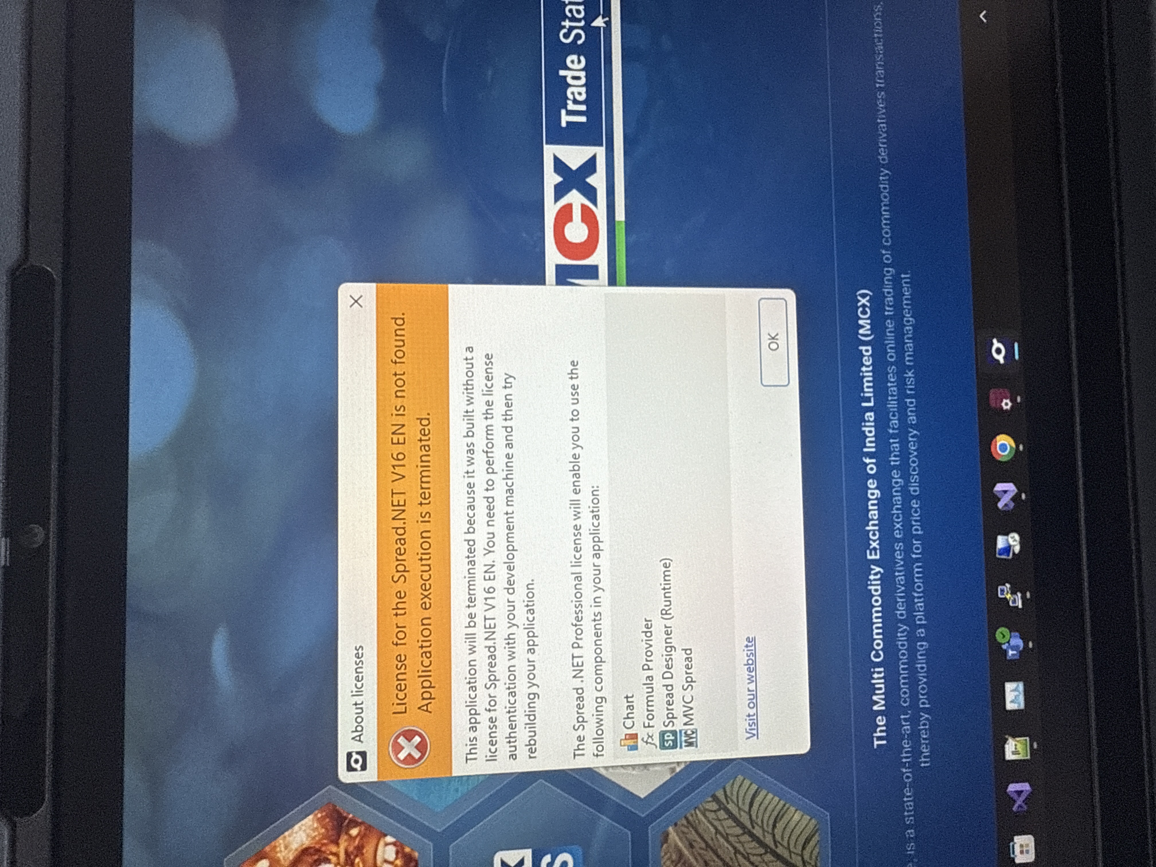

    We are getting a License not found for Spread Net v16 EN is not found error, we are building the application using Visual Studio 2022. We have purchased a License and have activated it on the build server.

  • Posted 25 April 2025, 2:40 am EST
    Hi Aastha,
    I tried using the solutions that you stated above but none seems to be working for me.
    I’ve attached the screenshots of GCLM and .gclicx file.
    I’am using Spread for Tabular structures in my project. I’ve included the .gclicx file in my root project.
    Yes, I’m creating a class library MWControl and ClockControl which are referenced in my root project(TraderWorkstation).
  • Posted 25 April 2025, 2:41 am EST - Updated 25 April 2025, 2:46 am EST
