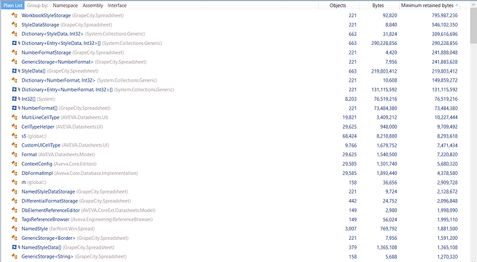

    We are using FpSpread with multiple Sheetview(at least 100), each SheetView might contain a lot of data and different cell types as well. When a SheetView gets removed from the FpSpread I would assume that the memory used by it gets released. I know that garbage collection kicks in at random times but in my case it never gets released.
    I tried multiple ways like
    Sheets.RemoveAt(i);
    pSheetView.Dispose();
    pSheetView = null;
    Also, I tried clearing the rows and columns and then ran dispose methods but, nothing worked.
    We also ran the performance profiler and saw that workbook styles and stylestorage objects are taking huge memory and it is not getting released.
    Hence with this issue, we can’t able to perform major functionalities in our applications and creating a negative impact on customers. It will be great if you fix this as soon as possible.
    Shared the performance profiler result, please have a look.

  • Posted 20 August 2021, 8:05 am EST - Updated 30 September 2022, 1:17 pm EST
    Hello Jitender,
    I even tried by explicitly giving the garbage ‘collect’ as suggested in the trail message, even then the result is the same.
    I need a couple of clarifications here,
    1. Is there any other way to dispose the whole FPspread with all the sheetview inside at once.
    2. While removing the each sheetview, why the sheetstylestorage and workbook sheetstyle storage still present in memory.
    I even thought for a while whether my system doesn’t have enought memory to handle, but I think we have sophisticated configuration with 32Gb RAM.
    Below is the point where exactly we are getting the issue,
