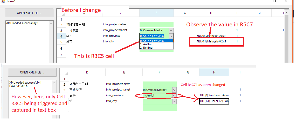

  • Posted 27 November 2018, 1:03 am EST - Updated 30 September 2022, 2:05 pm EST
    Hi, Jitender,
    I think I may not explained well in my previous message above.
    In the case 267418 which I sent by e-mail, I attached the screen-shot. May be I shall explain in more details about the problem here.
    As I mentioned in above message.
    …" The outcome is, only the single affected cell is reflected in the text box" …
    The affected cells are NOT ONLY Cell F4, but also cell H5, I expect H5 being triggered too, as all previous version of SP works in this way.
    The event however, only being fired for F4.
    That’s why the text box only return “Row 3, Col 5”
    I shall expect, the text box shows also ‘Row 4, Col 7’ if the library works correctly.
    Please find attached image may be better explain my meaning.

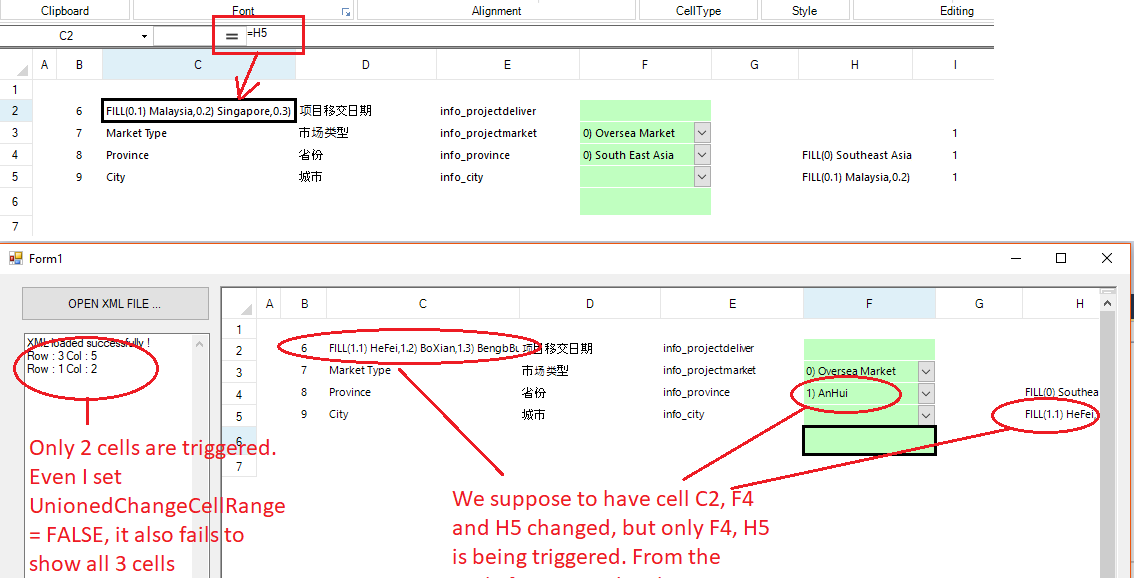

  • Posted 28 November 2018, 5:58 am EST - Updated 30 September 2022, 2:05 pm EST
    Dear Deepak Sharma,
    At the first glance it appears to work, but if I slightly modify the xml to add in more formula inside, it fails !!! Let me explain this :
    I am now putting in formula at C2 as in attached png. Now I run again the proposed change you made and the outcome fail to trigger all 3 cells
    If you remember in year 2014, May 27, I raised the same issue for SP7 ( please check the issue no 43329, Bug no 68108 ), the solution provided to me is setting UnionedChangeCellRange = FALSE. The officer supported this was yourself as in my record, and it resolved all issues of this.
    After that SP9, SP10 works perfectly with this, until it comes to SP11, issue appears again.
    Kindly take a closer look into this. You can write a few more formula around this cells, and you shall find not all cells are triggered.
    Raymond
