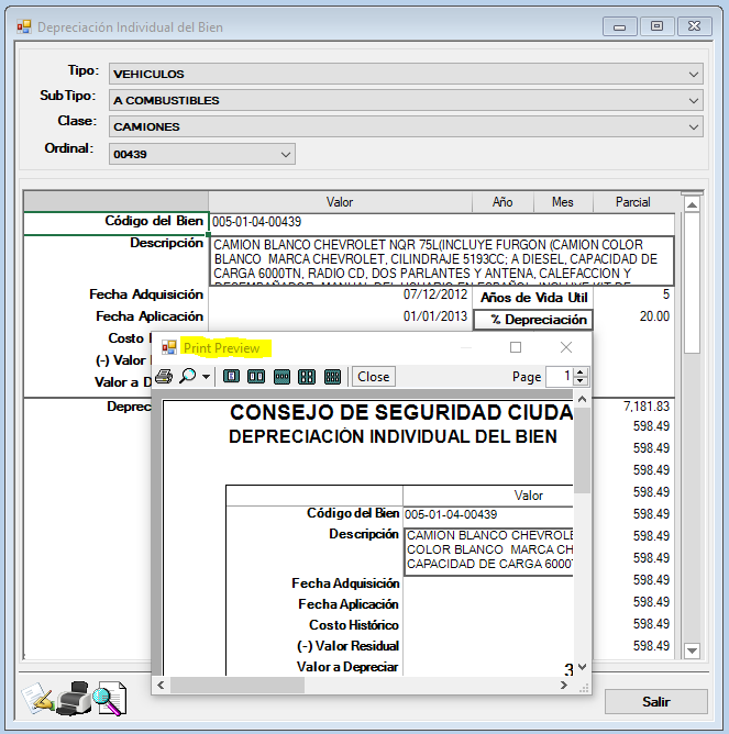

    Yes, I think I lacked clarity on the subject. I mean Print Preview.

    As you can see, the Print Preview window does not appear maximized and precisely that is the client’s requirement: that by default it appears maximized.
    Is there any property of PrintInfo to accomplish this?

    You can customize the print preview dialog to display it in maximized form if you set up another form with a PrintPreviewControl on it you can do the same.

       Private Sub FpSpread1_PrintPreviewShowing(sender As Object, e As FarPoint.Win.Spread.PrintPreviewShowingEventArgs) Handles FpSpread1.PrintPreviewShowing
           e.Cancel = True
           Dim f As New Form2
           f.WindowState = FormWindowState.Maximized
           f.PrintPreviewControl1.Document = e.PreviewDialog.Document
           f.ShowDialog()
       End Sub
    Please have a look at attached sample for the same.
