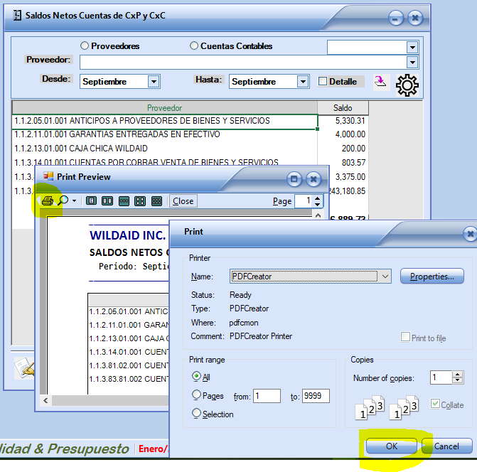

    Hi:
    I have an application in C # VS 2019 and I use the Spread.NET for windows Forms v12.45.20193.0. To print a spread sheet I use the following code:
    fpSpread.ActiveSheet.ZoomFactor = (float)nupZoom.Value;		//1
    fpSpread.ActiveSheet.PrintInfo.ShowColumnHeaders = true;
    fpSpread.ActiveSheet.PrintInfo.ShowRowHeaders = false;
    fpSpread.ActiveSheet.PrintInfo.ShowGrid = true;
    fpSpread.ActiveSheet.PrintInfo.ShowBorder = true;
    fpSpread.ActiveSheet.PrintInfo.ShowShadows = true;
    fpSpread.ActiveSheet.PrintInfo.ShowColor = true;
    fpSpread.ActiveSheet.PrintInfo.UseMax = false;
    fpSpread.ActiveSheet.PrintInfo.BestFitCols = false;
    fpSpread.ActiveSheet.PrintInfo.ShowPrintDialog = true;
    fpSpread.ActiveSheet.PrintInfo.PrintType = FarPoint.Win.Spread.PrintType.PageRange;
    fpSpread.ActiveSheet.PrintInfo.PageStart =1;
    fpSpread.ActiveSheet.PrintInfo.PageEnd = 1;
    fpSpread.Sheets[0].PrintInfo.Orientation = FarPoint.Win.Spread.PrintOrientation.Portrait;
    fpSpread.ActiveSheet.PrintInfo.Preview = true;
    fpSpread.ActiveSheet.PrintInfo.UseSmartPrint = true;
    fpSpread.PrintSheet(0);
    The application runs in Windows 10.
    But when you click on the “OK” button of the windows print manager, it does not print anything.
    If I run the application with source code with the IDE of VS 2019 … if it prints.
    Does not include the printer, this happens with anyone. What is happening?
