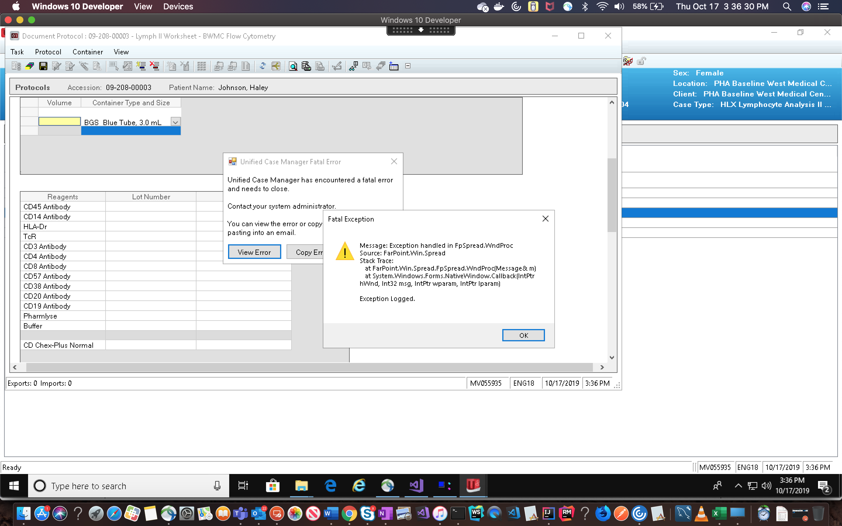

    I am getting a crash while trying to edit the cell, we are using a wrapper over EditBaseCellType and using an instance of Windows.forms inside it.

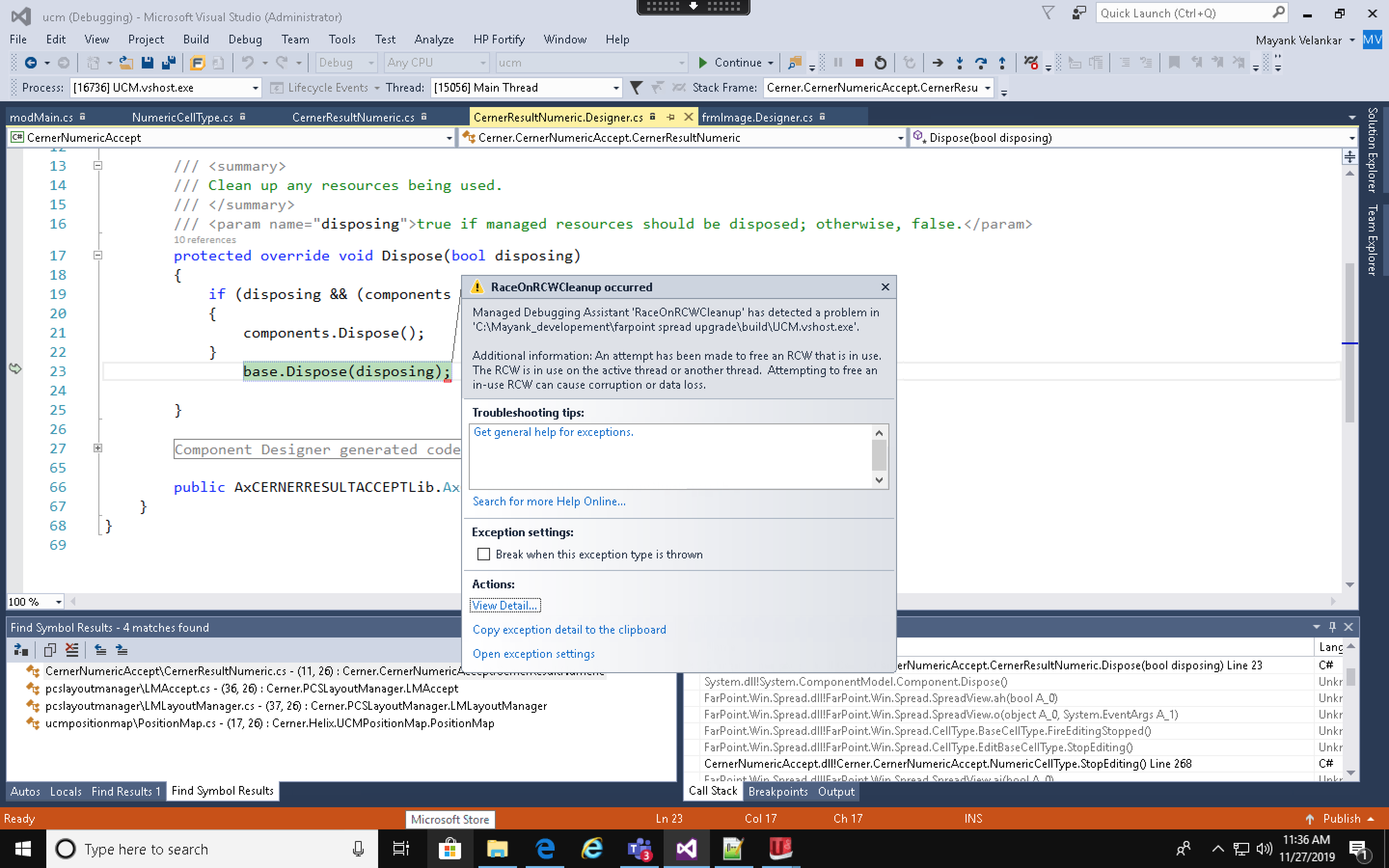

    The issue happens when we edit the cell for the first time and StopEditing event gets calls Dispose() for the base class, where the control gets disposed.
    Next time when we try to access control we get the crash, this issue was not happening in v7.35 and happens only after the upgrade.
    if I override the InitializeEditorControl and instantiate the form object there the issue gets resolved,
    is this the right way to do?

  • Posted 13 December 2019, 2:53 am EST
    Your first code seems to be incorrect:
    UserControl ResultNumeric accept = null;
    accept.LessThan = false;
    So, I’m not certain but it looks like earlier you were using a single UserControl instance as the editor. After your fix, you are creating a new instance on each edit, which is correct.
    If you still want to re-use a single instance, then you can implement ‘IReuseEditorControl2’ interface on your cell type.
