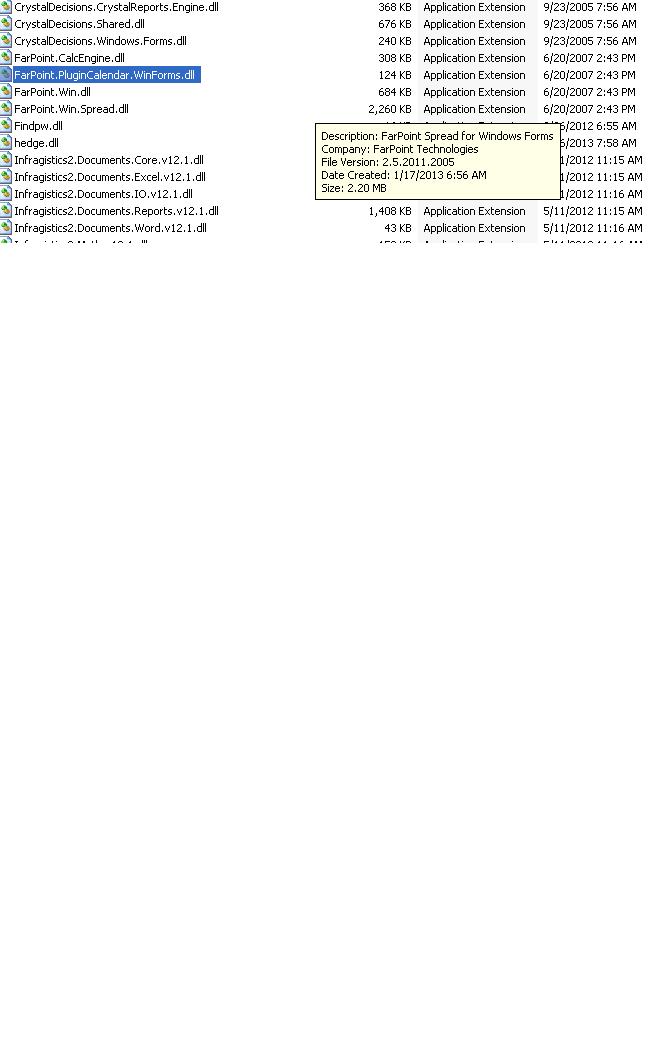

    We are trying to automate an application using RFT.The application contains few grids which belong to FarPoint Controls(like FpSpread For Windows Forms). RFT is not recognizing the contents of these grids. But we need to read the data from this grid and use it for further validation.We are not sure if any specific plug-in is required in order for RFT to recognize these controls.Pls guide us in this regard. Attached the screenshot of the FarPoint DLLs that are used in the application.

    Spread currently does not supports working with automation tools. However, I have entered a feature request (Feature request ID: #99931394) to provide better support for the use of automation tools with Spread in future. It would be implemented in the future releases of Spread. I regret for the inconvenience caused.
