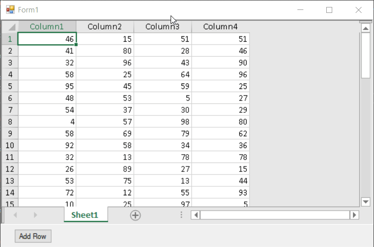

    Hi Piet,
    Please check the attached sample and GIF demonstrating the behavior I’m observing.
    Let me know if I need anything else to replicate the issue.
    ScrollToTopIssue.zip

  • Posted 12 July 2021, 6:53 am EST
    First thanks for your quick response, super!!
    Also forgot to mention my version: 14.45.20201
    I’ve tested your code sample and adapted to my way of working
    private void BtnAddRow_Click(object sender, EventArgs e)
    int row = fpSpread1.ActiveSheet.ActiveRowIndex + 1;
    fpSpread1.SuspendLayout();
    fpSpread1.ActiveSheet.SetActiveCell(row, 0);
    fpSpread1.ActiveSheet.AddUnboundRows(row, 1);
    fpSpread1.ActiveSheet.SetValue(row, 0, row.ToString());
    fpSpread1.ActiveSheet.AddRowToDataSource(row, true);
    fpSpread1.ResumeLayout();
    It works like expected, no problems at all.
    Now i wonder what is different in my application.
    I already checked my references. That all seems to be fine
    Any ideas?
    Regards Piet
