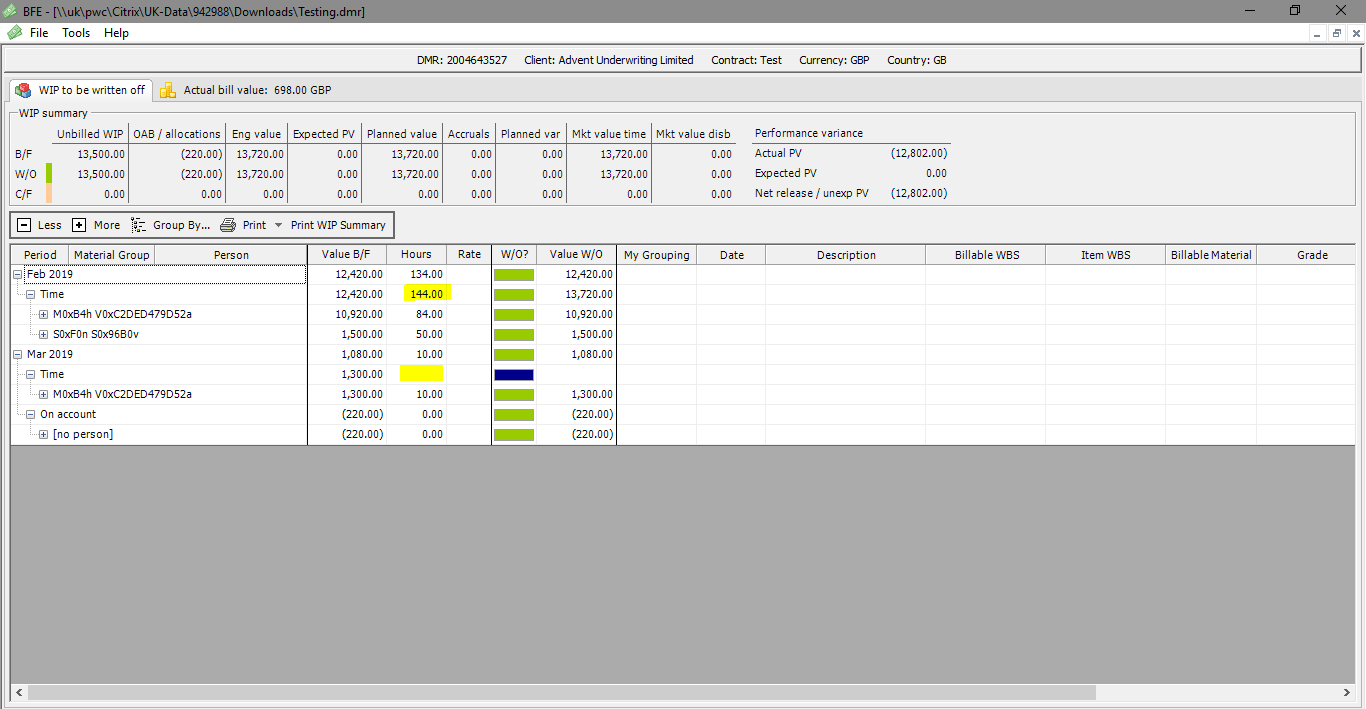

  • Posted 27 March 2019, 2:33 am EST - Updated 30 September 2022, 1:57 pm EST
    • We are displaying the column values in the grid with tree format by using C1FlexGrid.
    • We have migrated the Component One version from 2.0 to 4.0 in our winform application.
      After migration subtotal of each group is not getting displayed in the group header, its getting added to the first group header subtotal.
    Configuration setting before Upgrade :
    My application was developed in vb.net VS2003. We were used the following component one dll as below.
    C1.Win.C1FlexGrid.dll V2.6
    C1.Win.C1Command.dll V1.0
    C1.Common.dll V1.0
    C1.C1Zip.dll V1.0
    C1.Win.C1Sizer.dll V1.1
    b]Configuration setting after Upgrade :[/b]
    We migrated the code VS2003 from VS2015. We were used the following component one dll as below.
    C1.Win.C1Sizer.4.dll V 4.0
    C1.Win.C1FlexGrid.4.dll V4.0
    C1.Win.C1Command.4.dll V 4.0
    C1.C1Zip.4.dll V 4.0
    After grouping we are doing reaggregate as below:
    Private Sub RecalculateAggregates()
    ’ Assumption: row order doesn’t need to change, we just need to
    ’ recalculate the aggregate entries.
    fGrid.Redraw = False
    Try
    For Each agr As Flex.Column In GetCols(Grouping.AggregateCols)
    Dim level As Integer = 0
    For Each grp As Flex.Column In GetCols(Grouping.GroupCols)
                    fGrid.Subtotal(Flex.AggregateEnum.Sum, level, grp.Index, agr.Index, "{0}")
                    level += 1
                Next
            Next
            RemoveZerosFromAggregations()
        Finally
            fGrid.Redraw = True
        End Try
    End Sub
    We have not change an functionality as part of this migration, could you please help me on this subtotal issue in each group header. PFA screenshot for your reference with before and after upgrade of componentone.
