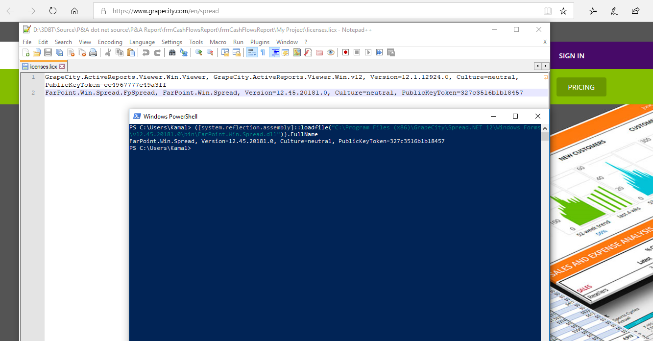

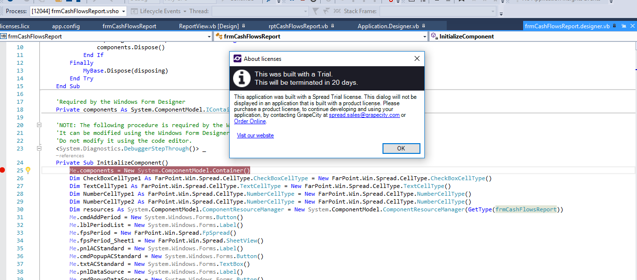

    Our Customer shared a source code which was built using licensed version of Spread.NET and Active Reports. To understand the functionalities we were using the trial version of above mentioned grape city controls. The build was successful but the form didn’t load instead it showed a message. “This application was built with a Spread trial license. This dialog will not displayed in an application that is built with a product license.” Attached the screenshot of the same along with the licenses.licx file for your reference.

    Hello Kamal,
    As you said that the application was built with a Spread trial license hence in order to remove the nag screen you need to purchase Spread License by contacting our sales team at “us.sales@grapecity.com” or from by purchasing it online using this link:-
    https://www.grapecity.com/en/download/spreadnet
    You can then use the License key to activate the product and use the application without nag screen.
