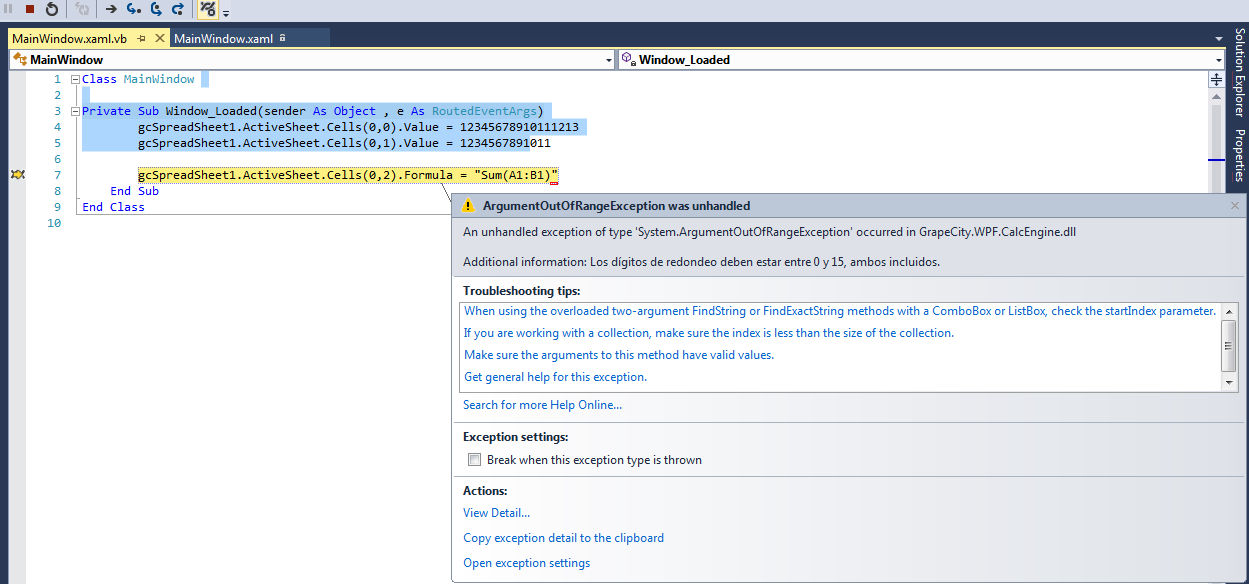

    I ran the same project you sent and I did got the same error. (see picture attached)

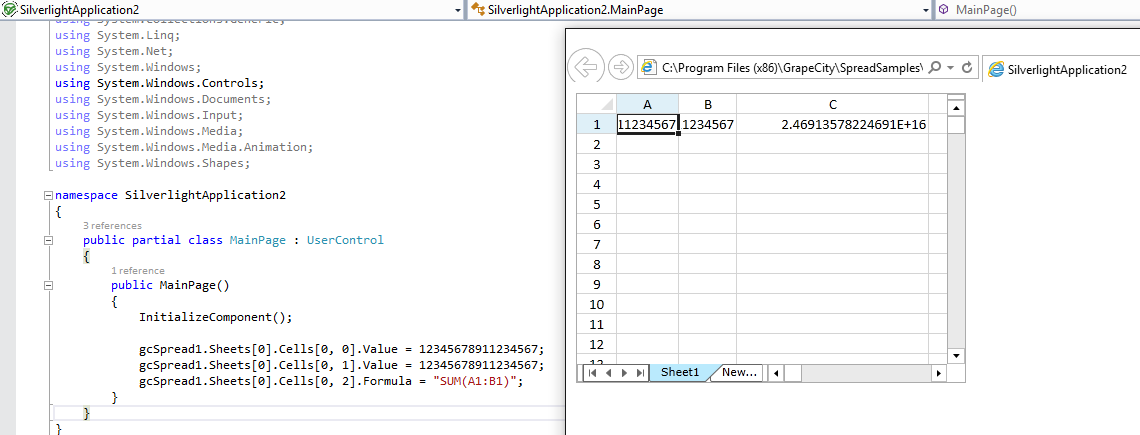

    In any case I’m using the Silverlight version of the spreadsheet.
    I’m sending you another example I made in silverlight.
    When you press the button below it reenables the CalcService and gives you the error.
    I wonder if there is a way to intercept the validation of the formula evaluation, in order to do something before the error is triggered, in my case I just need to round that value to 15 digits, because it happens also with numbers like 0,03020343543543534535, with long decimal digits.

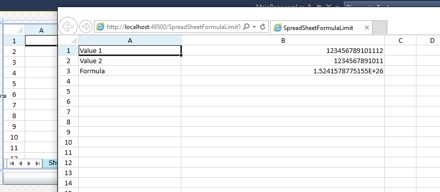

    I tried basic code as shown in the image and it seemed to work okay. Your project appears to have exceeded the limit. You might try a small, test project without the Spread Silverlight dlls.

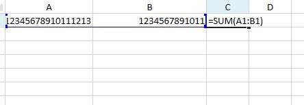

    I already posted in another thread, but now I found this and used the provided example. I get the following when editing:
    After pressing Enter the cell C1 is empty (the formula is not applied on C1)
