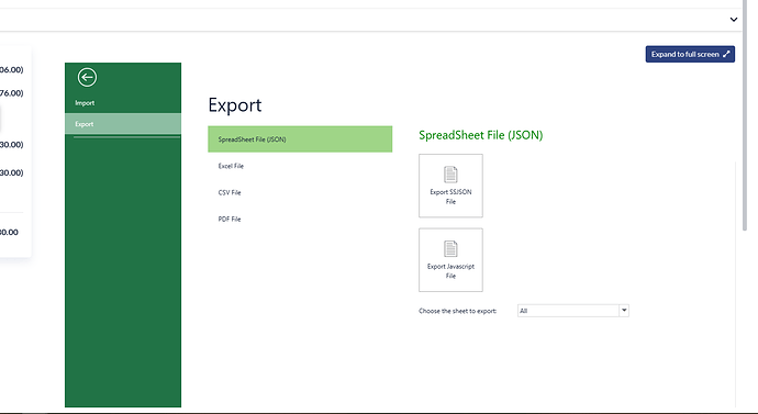

    Can the Export option be automatically selected when a user clicks on the File menu?

    For this, you may need to change the fileMenuSettingState. Please refer to the following code snippet and let me know if you face any issues.
    let fileMenuSetting = des.getData("fileMenuSetting") || {};
    fileMenuSetting.activeCategory_main="Export";
    des.setData("fileMenuSetting",fileMenuSetting)

  • Posted 28 February 2023, 2:59 am EST
    HI,
    We are sorry ut on our end it is working fine. Could you please share a workig smaple that replicates the issue so that we could investigate it further nad help you accoridngly. You may also refer to the following sample that we used for testing.

  • Posted 28 February 2023, 3:34 am EST - Updated 28 February 2023, 3:52 am EST
    It’s work!
    Thank you so much!
