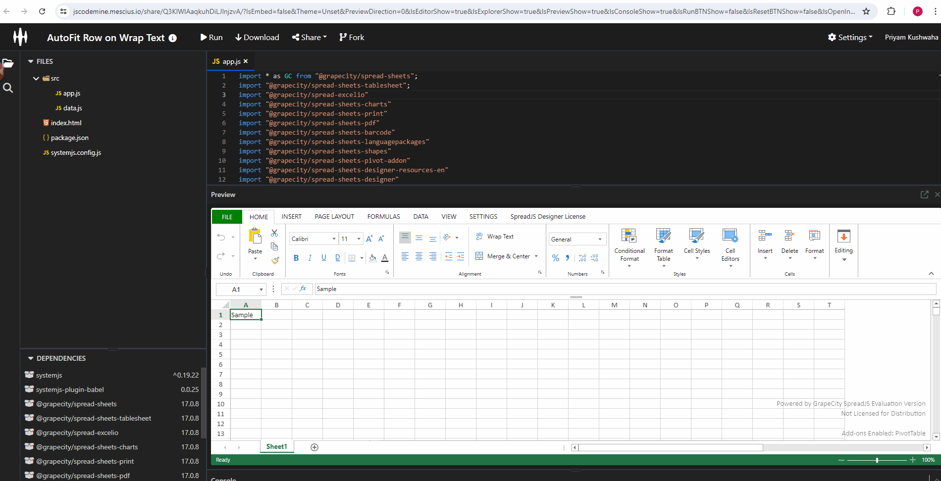

  • Posted 3 May 2024, 3:09 am EST
    The “wordWrap” and “autoFit” row are two different functionality and SpreadJS as a component, don’t do automatic conversion. SpreadJS provides several APIs to perform the same as Microsoft Excel.
    You could monitor the ClipboardPasted Event, check for the wordwrap and autoFit the row to the pasted range. Kindly refer to the following code snippet and the attached sample:

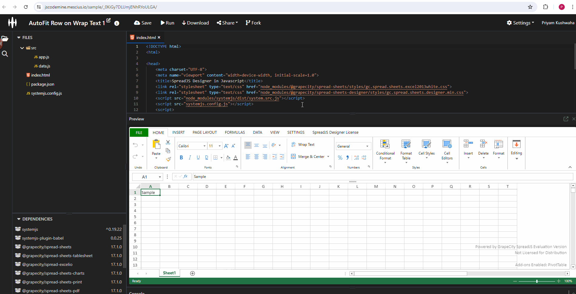

  • Posted 5 July 2024, 2:05 am EST - Updated 5 July 2024, 2:11 am EST
    I tested with the previously provided sample, and undo is working, but we need to perform the undo action twice to revert to the previous state. Refer to the attached GIF “version17.0.8behavior.gif”.
    Gif:
    However, after upgrading to the latest version 17.1.0, it works as expected. Refer to the attached GIF “version17.1.0behavior.gif” and sample.
    Gif:
    Sample: https://jscodemine.mescius.io/share/gw1WByPVE0SRFrxEc04QQg/?defaultOpen={"OpenedFileName"%3A["%2Findex.html"%2C"%2Fsrc%2Fapp.js"%2C"%2Fpackage.json"]%2C"ActiveFile"%3A"%2Fpackage.json"}
    If undo is not working on your end, to better assist you, could you share a sample along with the steps to replicate the behavior you have observed, or modify the existing sample to replicate the behavior? This will enable me to investigate the problem more thoroughly. Additionally, it would be helpful if you could provide a GIF or video illustrating the issue.
