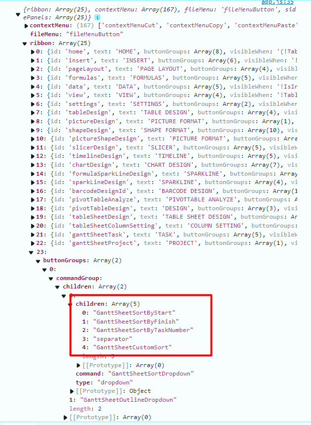

    How do I know the commandName of these GanttSheet functions
    They don’t appear in DefaultConfig
    And I would like to change some attributes
  • Posted 16 December 2024, 6:30 am EST - Updated 16 December 2024, 6:35 am EST
    Please refer to the names of the commands for corresponding to the image that you have sent.
    For Zoom:
    • GanttSheetSortByStart
    • GanttSheetSortByFinish
    • GanttSheetSortByTaskNumber
    • GanttSheetCustomSort
    For TimeScale Dropdown:
    • GanttSheetTimescaleDropdown
    Task Mode:
    • GanttSheetNewTaskMode
    You could refer to the following API for the command names: https://developer.mescius.com/spreadjs/api/designer/classes/GC.Spread.Sheets.Designer.CommandNames
    Sample: https://jscodemine.mescius.io/share/GgkLrsdWx0mpwTYq5uJzmg/?defaultOpen={"OpenedFileName"%3A["%2Fsrc%2Fapp.js"]%2C"ActiveFile"%3A"%2Fsrc%2Fapp.js"}
    Also, all the commands are available in the default config. Make sure, you have included the Gantt Sheet Reference. Refer to the following screenshot of the Default Config showing the commands. If you still face the issue with your sample, kindly share the sample with us so that we could investigate at our end and could help you accordingly.

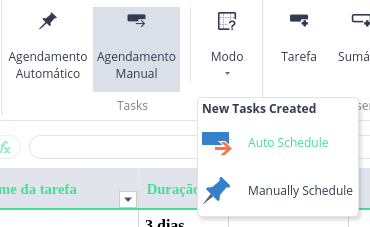

  • Posted 16 December 2024, 10:08 am EST - Updated 16 December 2024, 10:13 am EST
    But is GanttSheetManuallySchedule and GanttSheetAutoSchedule the same as the buttons inside GanttSheetNewTaskMode?
    Because I changed the icon but it didn’t change at all. And inside the Ribbon in GanttSheetNewTaskMode it doesn’t show anything
    GanttSheetManuallySchedule: {
          title: '',
          text: 'Agendamento automático',
          iconClass: 'icon-manually-schedule', // my icon
          commandName: 'GanttSheetManuallySchedule',
        GanttSheetAutoSchedule: {
          title: '',
          text: 'Agendamento manual',
          iconClass: 'icon-auto-schedule', // my icon
          commandName: 'GanttSheetAutoSchedule',

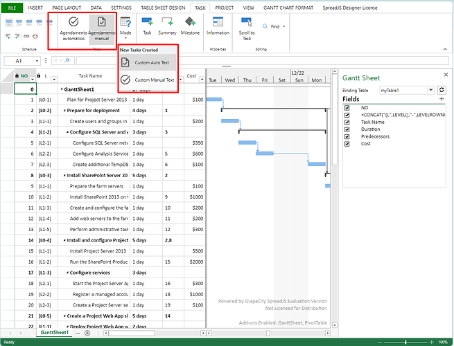

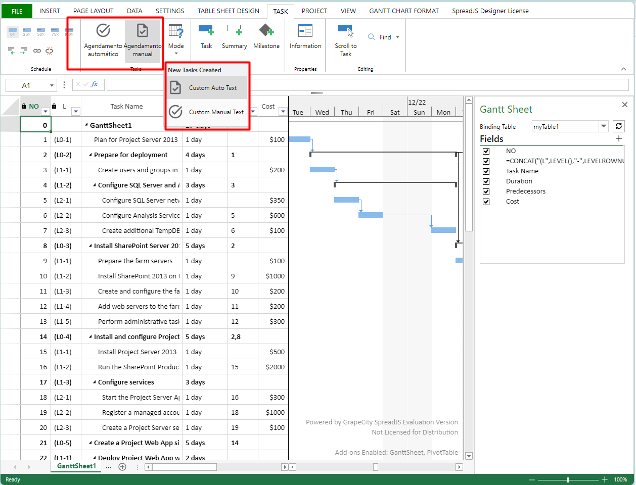

  • Posted 17 December 2024, 3:17 am EST - Updated 17 December 2024, 3:22 am EST
    I tested at my end and it seems to be working fine at my end. Here is the sample that I have tested with: https://jscodemine.mescius.io/share/qxfc3xlaoEG3Vip7xAjfvQ/?defaultOpen={"OpenedFileName"%3A["%2Fsrc%2Fapp.js"]%2C"ActiveFile"%3A"%2Fsrc%2Fapp.js"}
    I am using the following code snippet:
    let config = GC.Spread.Sheets.Designer.DefaultConfig;
    // Merge the new commandMap updates
    config.commandMap = Object.assign({}, config.commandMap, {
        "GanttSheetManuallySchedule": {
            ...GC.Spread.Sheets.Designer.getCommand(GC.Spread.Sheets.Designer.CommandNames.GanttSheetManuallySchedule),
            text: "Agendamento automático",
            title: ""
        "GanttSheetAutoSchedule": {
            ...GC.Spread.Sheets.Designer.getCommand(GC.Spread.Sheets.Designer.CommandNames.GanttSheetAutoSchedule),
            title: ""
        "GanttSheetNewTaskMode": {
            ...GC.Spread.Sheets.Designer.getCommand(GC.Spread.Sheets.Designer.CommandNames.GanttSheetNewTaskMode),
            dropdownList: GC.Spread.Sheets.Designer.getCommand(
            ).dropdownList.map(group => ({
                ...group, // Preserve existing group properties
                groupItems: group.groupItems.map(item => ({
                    ...item, // Preserve other item properties
                    text: item.value === "Auto" ? "Custom Auto Text" :
                        item.value === "Manual" ? "Custom Manual Text" : item.text,
                    iconClass: item.value === "Auto" ? "icon-auto-schedule" :
                        item.value === "Manual" ? "icon-manually-schedule" : item.iconClass
    console.log(config);
    designer.setConfig(config);
    Could you kindly share us a sample replicating the issue? Alternatively, you could modify the above sample and share it with us. In the sample, the icon class has been applied to the “index.html” file.
